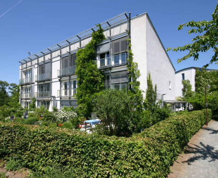

The global Passive House community is converging on Darmstadt, Germany, this week to celebrate the 25th anniversary of the Kranichstein Passive House and the 20th anniversary of the International Passive House Conference.
A great deal has changed in the world of building performance since the Kranichstein Passive House was first built. Much of that change we can attribute directly to the influence of this iconic building and the spread of the Passive House standard (which was derived from the efforts of Dr. Wolfgang Feist and others to model and optimize this particular building.) Triple-pane windows are now readily available in both Europe and North America, as are heat-recovery and energy-recovery ventilation units. A growing awareness of the benefits of airtight construction and detailing are also largely attributable to the global spread and influence of the Passive House standard.
My motivation for studying the Kranichstein building was largely coincidental. It grew out of my involvement in developing an optimization tool to help Passive House designers and energy modelers. The tool is called PDT-Passivhaus, or Predictive Design Technology for Passivhaus. This led me to dig a little deeper into how the Kranichstein project was designed and modeled.
My explorations revealed much about the evolution of the Passive House standard and my hope is that both the development of this optimization tool and information it has uncovered will be both interesting and helpful to others.

Why Kranichstein?
Quite conveniently, every copy of the PHPP software is supplied with a complete example project file of the Kranichstein Passive House building as the example project. We used this example file to develop the early versions of our optimization tool. It gave us a deep appreciation for both the complexity of the Passive House Planning Package and the effort that was taken in the design of the Kranichstein project.

What we found at Kranichstein
When running the Kranichstein project through our optimization tool, it became immediately apparent that every single one of the variables we selected was perfectly and precisely optimized to the Passive House standard’s heat load target of 10 W/m².
It also became apparent that its more widely known certification alternate, the heating demand target of 15 kWh/m²yr, was not as significant. Despite there clearly being a correlation between the 10 W/m² target and the heating demand target of 15 kWh/m²yr, it was clear that heating demand played a minor role in the design and selection of the Kranichstein assemblies and components.
All assemblies and components used in the Kranichstein building hewed very closely to the 15 kWh/m²yr target, with the exception of the specific window areas for each elevation. While the sum total window surface area of the building readily tracked both the heat load and heating demand targets, individually the total window areas for the south, north, and west orientations nailed the heat load target, but were clearly well below the 15 kWh/m²yr heating demand metric.
