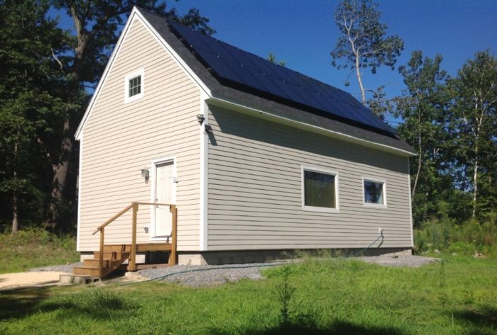

Recently I designed and built my home in Shirley, Massachusetts. The design goal was to build a net-zero-energy house. However, it had to be comfortable to live in, easy to build with low-skilled labor, and very affordable.
I had to keep it simple because I had my family for laborers, and they do not have construction skills. The home also had to be comfortable to live in, with adequate daylighting and easy circulation. The budget demanded that the house be kept small, but several design tricks involving lines of sight were used to make the space feel much larger than it actually is.
Most of my research showed that net-zero-energy houses were too expensive. However, becoming net-zero was one of the parameters for the house that I refused to compromise on.

I had a 4.8-kw photovoltaic (PV) array with micro-inverters installed on the south-facing roof of the house. The PV array connects to the electric meter on the outside of the house. This prevented more penetrations for wires.
It’s very, very tight
I conducted several blower-door tests; the final one was scheduled for after the drywall. A regular blower door could not be used on my house because it does not read below 100 cfm. Instead I built a plywood panel to hold a Duct Blaster fan in a window and taped the edges. I used a manometer in the normal manner for checking the whole house. With Ring 3 on the Duct Blaster I could pull an accurate number for the house. It was 22 cfm@50 Pa. This translates into 0.09 ach50.
While I conducted this test, the crawl space trap door was open and the outside HRV vents were open. I did not tape them off because the HRV has internal gaskets that close when off. To put this in some perspective, the 2009 IECC requires no more than 7 ach50. The new 2012 standard is less than or equal to 3 ach50. The Passivhaus standard, which is the most stringent in the world, is 0.6 ach50.
The bottom line: comfort
The end product is a bright and comfortable home. The spaces work well with one another. There is a mudroom when you first walk in with a bench to take your shoes off. The kitchen has plenty of countertop space. The main room has high ceilings, providing a sense that the house has more space then there actually is. There are two lofts which we have not used for anything but storage so far.
During the first winter, I purchased my electricity because my solar panels were not yet installed. There is no fireplace or wood stove, and I was just using the one electric baseboard unit for heat. My stove, oven, and water heater are all electric. There is no propane, oil, wood, or wood pellets on site. Electricity is the only energy source entering the house besides the direct passive gain.
My PV panels have recently been brought online. I’m monitoring the usage and am on schedule to be net-zero in a year. Now I have no heating or energy bills.

If you look closely at your photo, it perfectly supports the point I am trying to make above.
Penetrations
Where are the windows? This house sits on what looks to be a beautiful rural lot and has no relationship with its surroundings at all. If you showed it to anyone unfamiliar with energy efficient construction they would notice its failure to achieve any balance between efficiency and other architectural concerns. But for some reason it doesn't occasion any comment here.
This is fast becoming the defining characteristic for similarly built houses. Blog after blog features houses that subordinate everything else to the demands of the building envelope. I'm sorry for ranting, but this one-sided thinking denies a whole range of what it means to be human. Is the solution to our currently inefficient housing to lock ourselves in hermetically sealed containers with no access to our surroundings?

It seems some may of missed the point. Here is a net zero house in Mass. for $85k plus labor. Even down here in Texas, a "tiny house" could end up costing that much. Granted it is small with a 20 x 36 footprint (720 sq ft plus lofts) but it could be progressively enhanced and probably does not have a 30 year mortgage. Add a deep wrap around porch and enjoy the northeast climate.
Well put, rjp

David Posluszny built exactly the house he wanted. He paid for it himself and did much of the own work, and he's living in it -- without any energy bills. Millions of families around the world would think that they had won the lottery if they could own such a house.
Can you design a different house? Of course. Do you imagine one with more windows and a nice deck, or perhaps cedar shingle siding? Well, designing a different house isn't that difficult. So build it, and send GBA a guest blog about it.

Meanwhile, I'm wondering: a) Is there just the one door and just the one way in and out? b) Does the heat pump do any cooling in summer? Overhangs seem minimal. c) If we can achieve an ever lower ach50, do we have to worry about an outage with our ventilator? d) Is there a clothes line not pictured? e) Is a screened porch a possibility? f) Imagine an avenue with say 20 or so of the very, very tight design in a row.

Yes, I would have chosen higher performing glass in somewhat larger amounts, but that would be my choice. I think changing out the door to one of highly insulated glass would be a good idea, and reasonable to do yourself. Not being able to see who is at the door is annoying, but you know what, it is his house and he will get to live there[cheaply] for a long time to ponder it

Thank you everyone for taking the time to read the article. There have been some excellent comments.
1. There is a back door, plus all the windows in the bedroom are egress.
2. The front door was given to me by a friend, which is why I used it to get closed in. Two months ago I swapped it out for one with a window in it, so now I have a total of ten windows.
3. I can't wait to have a porch. It is on my short list of things to build.
Please understand that I saved my money to buy the land. I saved my money to buy building materials. And in a couple years I will have saved enough to build the porch. (I do have a small loan that will be paid off in two more years.) I'm also saving up to refurbish the garage. It would be great to have those things now, but I would rather not have a 30-year mortgage. So, without energy bills, all I have to worry about paying are my taxes, and water.
Thanks again for reading the story, and hopefully the construction details help a couple of you.

Two fixed windows? One can't even open a window on a nice spring or fall day! What about in a fire and the door is blocked? Why not operable windows? Yeah, that's a great selling point. Hello folks, welcome to your tomb, this home features 2 1/2 tiny windows that you can't even open.
