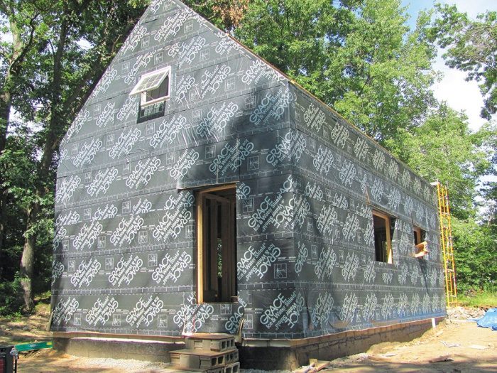

Does the exterior sheathing on a double-stud wall accumulate worrisome quantities of moisture in late winter? Several researchers are now looking into this question, and Green Building Advisor has been sharing the researchers’ findings as the information becomes available.
The latest sheathing moisture measurements were made by Bill Hulstrunk, the technical manager at National Fiber in Belchertown, Massachusetts. I’d like to put an important piece of information on the table from the start: Hulstrunk is not a disinterested academic researcher; he is employed by a company that sells cellulose insulation. Clearly, his company is more inclined to share data showing that walls insulated with cellulose are performing well, and might not want to share any data that imply otherwise. That said, some of Hulstrunk’s data are thought-provoking.
Hulstrunk shared his moisture content readings in a presentation (“Hygrothermal Analysis of Superinsulated Assemblies”) at the Passive House conference in Portland, Maine, on September 22, 2014. His co-presenter was builder Chris Corson of EcoCor Construction.
Hulstrunk began his presentation by lauding the hygroscopic properties of cellulose. “Hygroscopic materials want to redistribute and equalize the moisture,” he said. “Hygroscopic materials like cellulose protect themselves and nearby materials. They can pull moisture out of nearby materials like sheathing and studs.”
Hulstrunk also provided a few cautionary statements about cellulose density. “Deep cavities require that cellulose be installed at higher densities,” he said. “I recommend 3.7 pounds per cubic foot for a 12-inch cavity or 4 pounds per cubic feet for an 18-inch cavity. Deeper cavities require more experienced installers, since multiple hose passes are required.” (For more information on this topic, see How to Install Cellulose Insulation.)
Walls without any exterior sheathing stay dry
Bill Hulstrunk set out to visit a number of homes with thick double-stud or I-joist walls insulated with dense-packed cellulose, including several…

The reason what poorly insulated cathedral ceilings have sheathing rot near the ridge (as shown in the photo that you posted on David's blog yesterday) is that the ridge is leaky, and there are air pathways from the interior through the rafter bays to the ridge. The moisture is being carried by exfiltrating air.
That phenomenon clearly isn't happening at David Posluszny's house.

The thicker the bay, the more difficult it is too install cellulose -- and apparently the density has to go up, too. How dense does a 25-inch thick thick void at the ridge of the scissor truss need to be to eliminate settling (and thus minimize air exfiltration)? If it works, this is a great way to do a cathedral ceiling. I'm really curious as to what the results will be after several years of moisture cycling.
Response to David Hicks
David,
Q. "How dense does a 25-inch thick void at the ridge of the scissor truss need to be to eliminate settling (and thus minimize air exfiltration)?"
A. Even if the cellulose settles -- and I doubt that it will -- what does such settling have to do with exfiltration? David installed Ice & Water Shield over the entire roof, including the ridge. There is no ridge vent, and therefore no chance of exfiltration at this location.

Yes, I would vote for a method of establishing an exterior air barrier with materials that are more vapor-permeable.
As I wrote in the article, "Builders who want to establish an exterior air barrier don't have to use a vapor-impermeable product like Ice & Water Shield, of course. Standard recommendations for exterior air barriers include the Zip System (using OSB and a proprietary tape), plywood taped with Siga Wigluv (or some other type of high-quality tape), a vapor-permeable European air barrier membrane like Solitex Mento, or even a vapor-permeable peel-and-stick product like Henry Blueskin VP."
For someone as meticulous as David Posluszny, my guess is that the vapor-permeable peel-and-stick option (Henry Blueskin VP) would be the most attractive way to go. I imagine that there is an upcharge for switching from Ice & Water Shield to Henry Blueskin VP, however.

David and Bill H. also emphasize that thick dense-packed cellulose retards air flow by itself. So at this point, we don't even know how good the air barrier needs to be. Maybe a dense packed wall prevents infiltration without an air barrier? (Obviously a weather barrier is still required, but it comes free with the air barrier)

I disagree. David Posluszny actually included vent channels above the roof sheathing, so it could be argued that this is a vented roof. The only problem is that David didn't provide any way for the ventilation to help dry out the lower layer of roof sheathing in case it ever gets damp.
The solution is fairly simple: choose a roofing underlayment (or air barrier material) that is vapor-permeable instead of the Ice & Water Shield.

You wrote, "The rainscreen gap built into his stackup is somewhat wasted, given that the sheathing can't dry into the exterior."
That's the element of this situation that is so heart-breaking: David included these perfect rainscreen details for the wall, as well as ventilation pathways above the roof sheathing... but then he chose a material for his WRB / roofing underlayment that isn't vapor-permeable. The ventilated gaps provide tremendous drying potential -- the ability to pull moisture out of damp sheathing -- and yet that pesky Ice & Water Shield shuts down all drying to the exterior.

David, says exterior water leaks are the main problem not vapor. So he decided to use the most bullet proof method to asure exterior water proofing during the build out, and for the foreseeable future, roof changes siding changes not damaging his waterproof layer.
Straube mentions water leaks as the problem in his example. Ding Dong... David directly addressed what Straube found to be a problem. So logically it is an apples to oranges useless debate.
Those concerned about an interior barrier, David specifically addressed that too in his design and analysis. He does not have a barrier at the drywall on purpose, he wants vapor to get back into the interior with ease. And he feels the dense pack cells is the barrier to entry along with the fact that cells has some great moisture properties to take advantage of.
I am not advocating his build but I am defending his logic train verses those of you skipping around and missing directly the points David makes in his highly detailed review of the hows and whys and whats of his home.

David's roof has an air space above the sheathing that is impermeable due to ice and water layer.
Benefits may be many:
1 less nails in his Grace material, which is to be a 100% waterproof air barrier.
2 air space must help dry the roof
3 air space may lesson night time cooling reaching the cellulose containing sheathing that we don't want to get too wet and rot.
Either way, one thing noted many times is that cold sheathing is less vulnerable to rot than warm wet sheathing. Night time radiation cooling could be killing rot organisms every 24 hours which is a good thing.
If David's build works well, we should work to understand why and spread the lesson.

You wrote, "Benefits [of David's roof ventilation channels] may be many: ... air space must help dry the roof."
I'm not sure what you mean by "the roof." The ventilation channels will help dry out the upper layer of roof sheathing, but the lower layer of roof sheathing -- the layer touching the cellulose, which is the layer that is most in danger from winter moisture accumulation -- can't dry out to the exterior because of the Ice & Water Shield.
You also wrote, "one thing noted many times is that cold sheathing is less vulnerable to rot than warm wet sheathing." In fact, the reality is a little more complicated. Cold sheathing is actually more vulnerable, because it will accumulate more moisture during the winter than sheathing that is kept warm by exterior rigid foam. If the damp sheathing could be kept cold year 'round -- a situation that occurs in Antarctica, for example -- then rot would be impossible. But in Massachusetts, temperatures during the spring rise to the point where mold and rot are real worries. If we want to avoid these worries, warm sheathing is generally safer than cold sheathing.

Yes the roof to me is the roof shingles and it's sheathing layer. That airspace sets up the very bullet proof under roof to be an order of magnitude more safe if that is ever possible as far as EXTERIOR moisture causing any moisture harm by LEAKING INTO the inner layer that is the vulnerable layer of sheathing. David believes that exterior water is the main problem in a build like his.
His in house moisture has to get past dense pack cellulose. The cellulose near the inner wall is warm enough to be not wet from in home humidity. One side of this cellulose sponge is trying to stay dry. There is reason to believe David has built a working system. Bill Rose is the expert, I am all ears.
As to cold and rot... the worst rot I see is when an inch or so of rigid is attached to exterior sheathing. There may have been flashing leaks too. Basic carpentry done by most carpenters, AT JLC Providence RI there is not what not even 1% of the nations carpenters standing at close attention to the 30 minute window flashing event. 10-15 of us... out of millions.

Jason: " the real purpose of the gap is to ensure the durability of his Grace Ice/Water shield when the house is re-roofed/sided. Yes, it's self-healing, but given the assembly's reliance on air tightness, I think it was worth putting in."
With a self-stick membrane penetrated by a nail going into 4'x8' plywood there is effectively ZERO air leakage from those nail penetrations- a weak argument at best>
