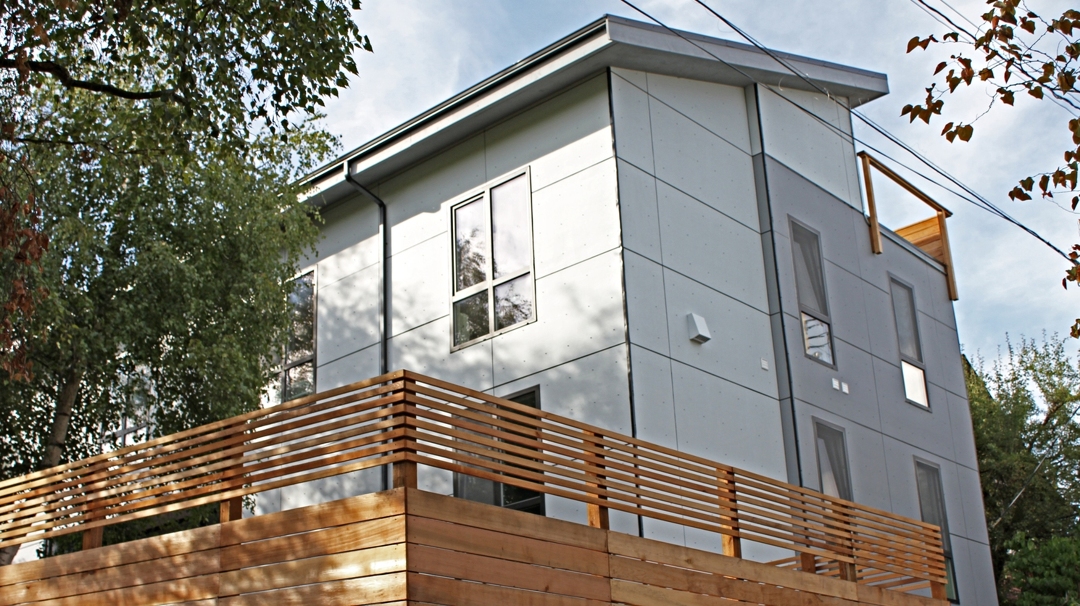

A Seattle couple spent two years searching for their dream home before deciding to build a new custom home. They turned to zero-energy-home builder Ted Clifton, Jr., who built them a modern two-story house with a mother-in-law suite and views of Lake Washington from the rooftop deck.
Clifton, the owner of of TC Legend Homes, calls the home a “positive energy home” — one that produces more energy than the home itself consumes. In fact, the home should produce enough electricity to power an electric car with the charging station set up in the garage.
The home’s modern asymmetrical design lends itself to the extra-large south-facing roof, which holds 36 photovoltaic (PV) panels rated at 9.7 kilowatts. The home achieved a Home Energy Rating System (HERS) score of -1 with the PV array, or 42 without the PV; a home built to the 2012 International Energy Conservation Code (IECC) would score about a HERS 70.
The home meets all of the high-performance requirements of the U.S. Department of Energy’s Zero Energy Ready Home program. To be certified as a DOE Zero Energy Ready Home, the builder must meet Energy Star Indoor airPLUS and WaterSense requirements, the insulation requirements of the 2012 International Energy Conservation Code, additional DOE Zero Energy Ready Home efficiency requirements, and have renewables or “renewable-ready” measures installed.

The walls and roof of the home were constructed of structural insulated panels (SIPs), which consist of rigid foam sandwiched between two layers of OSB. The foam adheres to the OSB and hardens during the manufacturing process, creating a strong bond and a very sturdy panel. The SIPs are cut to order in the factory, providing straight, clean, and dry walls with high shear strength. The panels arrive at the site ready for quick assembly. The 6-inch-thick walls provide R-26 of insulation; no additional insulation is needed.
SIPs provide an airtight wall because SIP walls have far fewer seams than stud walls. Even so, Clifton’s crew takes additional steps to ensure the airtightness of the building envelope. Where the SIPs connect to the ICF foundation wall, Clifton uses sill seal plus two beads of SIP mastic under the SIP panel. The wall-to-floor seam is caulked all along the inside perimeter of the home, then the baseboard is installed and caulked along the top and bottom edge.
The exterior walls were clad with prefinished smooth fiber cement siding that installs in 4’x8′ panels for a sleek, modern look. Metal Z-flashing was installed between the panels to direct water out at the seams. A corrugated draining housewrap provides an additional layer of protection, serving as a water-resistive barrier under the cladding.
The home has no attics. The roof assembly consists of 12-inch-thick R-46 SIPs that provide roof deck, support, and insulation in one product, making construction of the cathedral ceilings a fast and simple process. The standing-seam metal roofing is highly durable and adds to the modern appearance of the home.
Air-sealing measures address all seams
Before drywalling, Clifton’s crews foam the rough openings and caulk around all the windows; foam behind all the electric boxes and caulk around them; and foam and/or caulk around the electric wires and plumbing pipes. All of the SIP seams are both caulked and taped, in addition to the tape and mudding done by the drywallers. This attention to detail helps Clifton achieve a very airtight building envelope.
The blower-door test result was 0.97 air changes per hour at 50 Pascals pressure difference (ach50), which is more airtight than the stringent 2.5 ach50 specified by the DOE Zero Energy Ready Home program requirements for the marine climate, but not quite as tight as the target specified by the Passivhaus standard (0.6 ach50).
