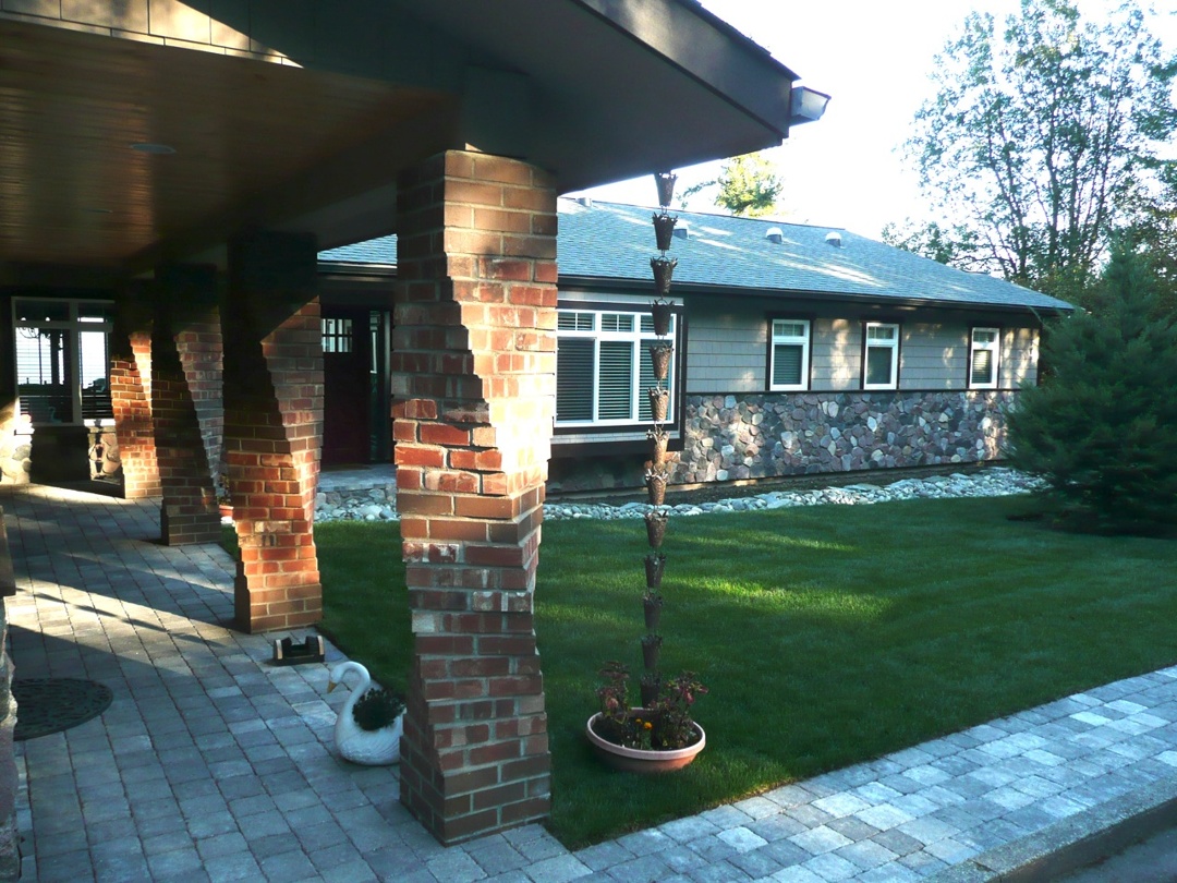

The use of structural insulated panel (SIP) technology makes for a high-performance “overcoat” for a serious home energy retrofit
Ted Clifton has been building and remodeling homes for more than 45 years. But he continues to recognize good innovations as they come along. That’s why he decided to use nailbase insulation panels on a recent green remodeling project for Bob and Tobie Johnson of Oak Harbor, WA.
What is nailbase insulation?
Nailbase insulation panels are essentially SIPs without the interior OSB skin. The panels keep the exterior OSB skin as the nailbase for the new cladding. Many SIP manufacturers, including Premier Building Systems, which manufactured the panels used by Clifton, are now making nailbase insulation panels.
“What is great about nailbase is that you get air sealing as well as insulation,” said Clifton. “We were able to cover the rim joist, which is typically a major source of air leakage in older homes.”
The nailbase insulation panels are fastened directly to the existing structural sheathing of the home, after the existing cladding has been stripped off. The same high performance screws used in conventional SIPs are used with the nailbase panels.
Clifton has also used the nailbase insulation panels to retrofit roof assemblies, although with the conditioning boundary on this home remaining at the ceiling plane, raised heel trusses were used on this project.

In addition to using spray foam sealant at all panel joints and caulking every bucked window and door opening to the nailbase insulation panels, Clifton custom-routed each panel on site. “We do it all on-site for this type of work. We need to fit existing openings precisely, and we would never be assured enough of the accuracy of the existing framing to have the openings fabricated at the factory,” said Clifton. “In addition, at the top corners of the walls, we used 2×2 steel angle flashing under the drywall, to provide a better seal at the plate line.”
The other detail that looks challenging is the triple-window bump-out in the guest room. Clifton weighs in on this detail: “The whole bump-out is SIP panels; this is a ‘trick’ we have been using for some time. We simply cut the opening 13 in. bigger than the window rough opening all the way around, then install the top SIP full width of the opening, then the two sides all the way to the bottom, then the bottom panel in between. The sides hold up the top and the bottom, they have plenty of leverage along the sides to extend a goodly ways… We do add a few square feet of surface area, but it is all R-25 SIP panels.”
