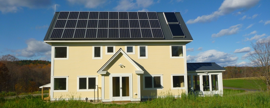

With double-stud walls, thick attic insulation, and triple-glazed windows, this home can be heated with just two ductless minisplit units
Before we met, my clients had spent considerable time researching how to build a net-zero home. They read product literature, studied the economics, understood the benefits, and had a pretty intelligent understanding of construction methods and materials. This body of knowledge became the starting point for our discussions and direction.
We took a “whole house” systems approach, refining the design to include building envelope details, floor plans, and elevations that would work in concert with the mechanical systems, site location, and renewable energy resources. The clients wanted a home that took advantage of natural light, was comfortable in all the New England seasons, and was free of toxic materials and mold.

A site with good solar exposure
My clients purchased a five-acre former cornfield in the town of Shelburne, Mass. The site affords wide views over the Pioneer Valley and excellent solar exposure; the photovoltaic system installers later confirmed that the site has a 98% solar window. The land slopes in various directions but the ideal house site is relatively flat, albeit constrained slightly by an eastern buffer zone from a nearby pond and property line corner to the west. Given the site conditions — lots of ledge — we opted for a small 10’x18’ basement and an insulated slab on grade with 4-foot frostwalls.
