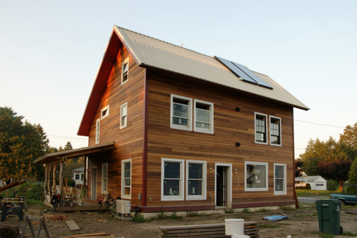

The superinsulated home that I designed and built for my family of three in Greenfield, Massachusetts has been comfortable for the entire year and serves as an example of successful design for our climate. We moved in to our new home in February 2012.
Modest in size, our home measures 26 feet by 32 feet and has 1,500 square feet of living space, with two full floors plus a partial third floor tucked into the slopes of the cathedral ceiling. In order to decrease the overall volume while maximizing south-facing exposure, we chose a saltbox shape.
An opposing design goal was a sense of spaciousness, which was achieved with higher ceilings. The first floor has 9-foot ceilings, while the master bedroom’s cathedral ceiling is a rather tall 15’6″. Closets, utility spaces, and bathrooms were all positioned on the north side of the house, and generous windows allow natural light (and solar heat) to enter all but one of the living spaces. To facilitate the movement of heat throughout the home, we chose an open floor plan and included an additional air passage between floors adjacent to the stairwell.
A thick concrete slab and lots of south-facing glass
The house is built on a slab and makes use of passive solar design. One quarter of the south-facing wall is glass, which is significantly greater than design norms. The 7-inch-thick slab is thicker than usual. Since the majority of our windows are conventional double-pane windows with standard low-e coatings, we have a weighted average SHGC on the south of only 0.33 — not as high as some passive solar designers recommend.
When the house is not heated by the sun, we use a single 12,000 Btuh Mitsubishi air-source heat pump located on the first floor. When the outdoor air temperature is 5°F, this ductless minisplit unit is capable of putting out 11,200 Btuh. Other than internal loads (appliances, lights, occupants and cooking), there are no other heat sources.
The home has been very warm and comfortable throughout the winter. Since our modeled heat load is 15,000 Btuh (0°F outside, 68°F inside), I was concerned that we weren’t going to be warm enough. Most of the difference may have been made up by using nighttime single-cell cellular blinds on 83% of the glass. (More details on performance are in the next section.)
Double-stud walls filled with cellulose insulation
The house has lots of insulation and a very tight envelope. The blower-door test showed that the house has 0.54 air changes per hour at 50 Pascals. The home has double-stud walls with 12.5 inches of dense-packed cellulose (installed at a density of 4 pounds per cubic foot). The roof is framed with parallel-chord trusses insulated with 21-26 inches of cellulose (depending on the pitch of the roof).

I was originally planning on dense-packing the trusses, but later realized that this was not going to be possible due to their depth, and was probably not desirable since the roof assembly was going to be unvented. Switching the design was costly, since the change didn’t occur until we were almost ready to insulate. The change required the installation of an interior air barrier and the creation of a 4-inch-deep ventilation channel by stapling Typar to the underside of the top chords of the trusses. We also reinstalled the ridge cap with Coravent under it. Our insulation contractor then filled the cathedral ceilings with a “medium pack” of cellulose, installed at a density of 2.5 pounds per cubic foot — dense enough so that it won’t settle.
The foundation has 4 inches of XPS below the slab, and 6 inches of XPS installed vertically against the stem wall.

Electric bill for the first year: $700
In its inaugural year, our all-electric home used 4,200 kWh costing us $700. During this period there were 6,691 heating degree days (base 64°F). Unfortunately, we have no way of parsing out how many Btus our heat pump put into the home. Going forward, there will be a TED 5000 energy meter that will allow us to log and compute this data. As I mentioned earlier, the home has been satisfactorily heated. The bedroom doors are normally open, but when closed, some guests have preferred a little extra warmth (provided by a space heater).
The heat pump is normally set to 63°F during the day and 59° at night. Interestingly, a data logger on the first floor recorded an average temperature much higher than the heat pump set points. From October 23 through January 27 it logged an average of 68°F with a range of 62° to 73°F. Even on overcast days with minimal or no solar heat gain, the logger recorded temperatures 3°F higher than the heat pump set point. Perhaps the discrepancy has something to do with the window or slab temperatures, although there is a fair bit of furniture in the way of the slab.
During this period, the data logger recorded an average relative humidity (RH) of 48% with a range between 39% and 67%. The logger was subsequently moved to a second-floor bedroom, where it recorded an average temperature of 65°F with a range of 61° to 72°F. The average RH in the bedroom was also 48%, with a range of 43% to 58%. The humidity has undoubtedly been greatly affected by indoor laundry drying. On average, we did one large load of laundry per day.
