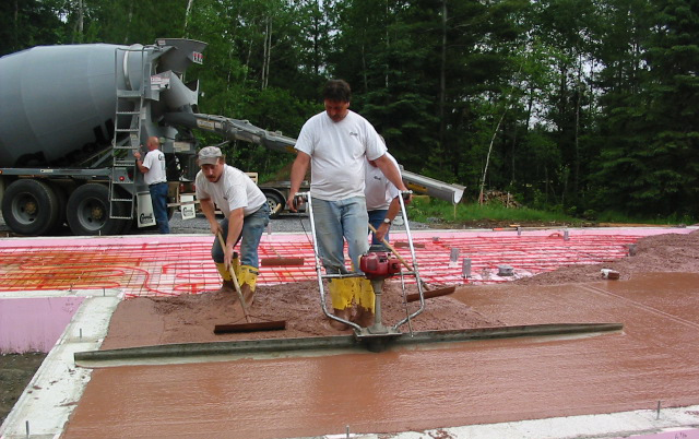

![](http://images.greenbuildingadvisor.com/app/uploads/2018/07/24232515/Riversong%20slab%20pour%202_0-main.jpg)

Image Credit: Robert Riversong A frost-protected shallow foundation requires less excavation and a smaller volume of concrete than a conventional foundation. The dining room includes a wood stove.

The site was perfect for a shallow foundation
The client’s land was on both sides of the street. She decided to subdivide the section opposite her existing log house to create a second building lot. The level, grassy site had just enough room for a deep well, an in-ground septic system, the footprint of a house, a (future) two-car detached garage/apartment, and a 16-ft. connecting breezeway with a pressure-treated deck.
The well-drained ground is gravel to a depth of 6 ft., underlain by sand. The soil would allow a shallow foundation with no need for sub-soil drainage. A sub-slab radon vent mitigates any potential for soil gas entry, and underground drains divert rainwater to nearby woods.

Foundation: Slab placed inside of a frost-protected shallow grade beam
Underslab insulation: Horizontal R-10 XPS under entire slab and vertical R-10 at slab edge
Foundation perimeter insulation: Vertical R-10 XPS at exterior of foundation and 12" of R-10 horizontal wing insulation
