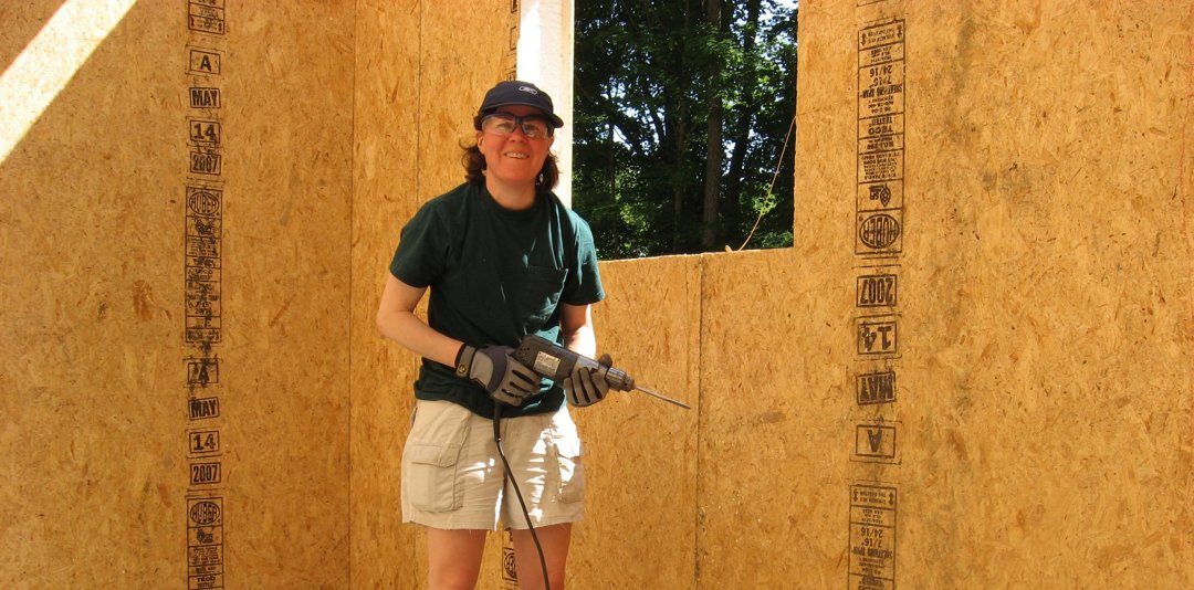

Now it was time to erect the wall panels — a process like putting together a puzzle. It’s a relatively simple process. The panels are numbered, and the door and window openings are cut out at the factory, so all you do is place the first panel on the mudsill (using P400 construction adhesive to seal any possible air leaks), check to make sure it’s square and level, and nail it to the sill. Then you move to the next one — just like painting by numbers.
The panels are joined together with a 1×4 vertical spline on the inside of each side of the joint where the two panels meet. The panels are nailed together; then holes are drilled through the spline every 8 in. These holes are later filled with spray foam insulation, creating a very tight envelope. Sealing potential air leaks is a key to obtaining the Energy Star rating.
Since we designed an open-plan first floor, the supports for the second-floor beam would be exposed, so we specified timber framing. The exposed timber framing adds a warm look to the house. We hired timber-frame contractors (Garland Mills); they came down and together we placed the posts and beam across the center of the building.
The entire shell, including the roof, was completed in eight 12-hour days by four of us, with help from the man-lift I rented. The timber framers were on site for about a day.
