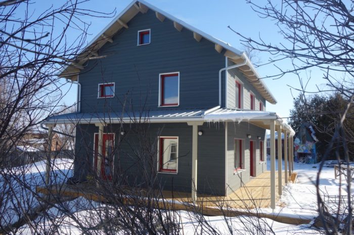

Editor’s note: David and Kayo Murakami Wood are building what they hope will be Ontario’s first certified Passive House on Wolfe Island, the largest of the Thousand Islands on the St. Lawrence River. They are documenting their work at their blog, Wolfe Island Passive House. For a list of earlier posts in this series, see the sidebar below.
We have received a copy of Anthony Mach’s final report on our place, part of a comparative study that also looks at another Passive House project in Peterborough, Ontario. We’re not going to comment on the Peterborough project because we know very little about it and it’s very different than ours. But, with Anthony’s permission, I will just highlight some parts of the report as it relates to this house.
Anthony, a Certified Passive House Designer, compares our house to the new, highest Canadian code standards. Bear this in mind, because the average Canadian (or U.S.) house wouldn’t have been built to anything like those latter standards, and as for the average older house on Wolfe Island… well, let’s just say, you could probably punch a hole through the wall of many houses here, our old one included!
I think Anthony has been somewhat conservative with his estimate of the R-value of the walls and ceiling (see Image #2, below). The whole assembly (including the cross-laminated timber, which has an R-value of between 4 and 5 on its own, and siding) would be nearer R-50 in my view. But conservative estimates are better than exaggerated claims for testing efficiency. This leads to some estimates for heat loss, which are summarized in image #3 below.
I’m also surprised by how much heat loss there is through the walls in these estimates, but apart from my feelings about R-values, I don’t have any basis for challenging this – it just seems like more than I would have expected. But the important thing is that our energy consumption is reduced dramatically (see Image #4, below).

There is a lot more in the report, but overall, Anthony characterizes our project as a successful one, and since he visited, we know he likes the place! We are really grateful to Anthony for carrying out this research, as we never would have had such a detailed understanding of the house without it.
