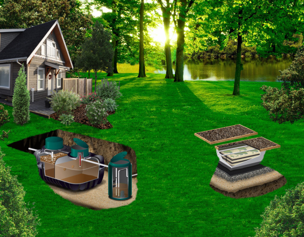

A low-profile septic system
As for the septic system, we decided, as with most things, to get it right from the beginning and had an excellent local sewage engineer, Martin Burger of Groundwork Engineering in Kingston, take a look at the site and design us a system to suit our needs and the legal requirements.
He identified two systems that would work best for us: Premier Tech’s Ecoflo biofilter and the relatively new Waterloo Flat Bed biofilter. Both are good systems and both have similar annual inspection requirements from the makers. But the Waterloo system needs less excavation and is less prominent in the landscape than the Ecoflo, so that’s what we’ve selected.
