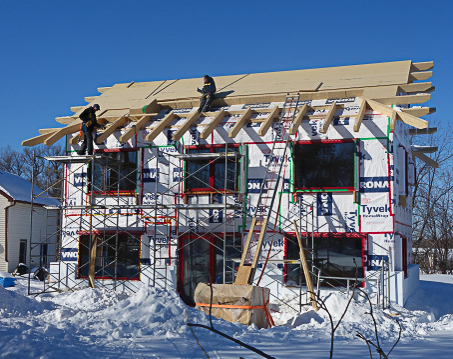

The roof of our new house, like the exterior walls, is made with cross-laminated timber (CLT) panels, so it doesn’t need any conventional framing. But we did need rafters at the perimeter of the roof to support the roof overhang, and the rafters had to be sanded and stained before they could be installed. In order to do that, we had to keep the temperature in the house above 10ºC (50°F), when it’s been down to -15ºC (5°F) outside, so the air heater inside has been vital. It’s somewhat ironic to think that keeping this temperature will be easy once we have the insulation on.
The roof overhang will shade the upper-story windows on the south side from direct summer sun — vital in preventing the house from overheating — while maximizing solar gain in the cooler months. Inside blinds don’t actually prevent summer overheating; while they act as a barrier to light, they still allow heat into the house. Outside blinds mean extra complications.
The veranda roof will do the same for the lower-story windows. The overhang also will make the roof area larger, enabling us to maximize our solar power generation (when we eventually fit the panels). Roof overhangs do many other useful jobs, however unfashionable they currently appear to be with architects who want their roof edges to be flush to the walls, largely for the sake of a “clean” look.
Given that we don’t need them to support anything more than the overhang, our rafters are short and are screwed into the CLT roof panels. The insulation will be cut to fit around them, and they will then be covered with an additional top layer of wood fiber insulation, then wide strapping, and finally the steel roofing. The strapping has to be sturdy enough to hold down the insulation as well as support the steel roofing and, eventually, the solar panels.

The work was performed in February, during a warm spell — well above freezing — which means the crew has been able to get on with installing the rafters. While they were drying we also managed to wrap the whole house — finally — and just in time for what looks like very heavy snow and rain later this week.
In addition, with the house getting warmer, due to both the warm weather and the heating, the remaining water that had frozen inside the CLT structure after very heavy rains in January is coming out (for more on that problem, see the post from January 10, 2016). This is getting us closer to drying everything properly. Once that is done, we can put floors in.
We were expecting a return to more normal, and colder, temperatures as well as snow. But before all this hits us, the crew has had time to prepare for insulating the roof. This will need two things: cutting the wood fiber panels into the exact shapes required to fit in between the rafters; and devising a system for getting the heavy insulation panels where they are needed.
Both problems have been worked out. In particular, the crew managed to rig a combination trolley-pulley system using a ladder, that seems to work very well in getting the panels up to the roof (see Image #3, below). Now we just need some reasonable weather to get it done.

For a house with otherwise continuous insulation, don't the applied rafter tails represent a substantial thermal bridge?
Roof Framing
Possibly, Malcolm. The rafters don't bridge to the outside - they are covered by the outer layer of insulation - and we were advised that according the PHPP calculations, it doesn't make a huge difference. However I'm not entirely convinced - having portions of the edge of the roof which are essentially just over 14" of solid wood and only 1 1/2" of insulation must make some difference. So it's something I am going to be keeping an eye on. My instinct is to add some more insulation inside the CLT roof in the attic space under the rafters. The tight corners under the eaves are basically unusable for any other purpose anyway, so it wouldn't reduce the potential utility of the space up there by very much.
Rafter tails
David, I think Malcolm was referring to the rafters sticking out for the overhang, past the insulation. Those are the tails, which are completely open to the cold outside air. Adding some insulation to the underside, especially near the eaves sounds like a good idea, although where it is most needed is also where you have the least space available.
Rafter tails
Oh yes, of course... I didn't read it carefully enough. Interesting point. I will have to ask the rest of the team.
Timber thermal bridge
What's the compressive strength of this insulation? Would it be possible to place rafter tails overtop? I have a similar plan in mind and would like to use 12" of the high density roxul on the roof and then frame a structure of 4x4 pine overtop to support overhang
Rafter tails and thermal bridging
Okay, so I've had conversations with various people involved in the design and build. The short answer is that yes, the rafter tails are inevitably thermal bridges in a limited way. Remember that they will still have an R value of something like 1 / inch. There will be some points at which the distance between the inside of the CLT roof / wall and the nearest outside edge of the rafter that is exposed to the air is less than 20" and therefore the R value at those particular points is at most ⅓ of the R value of the rest of the roof / wall assembly. That's still far more than any window (even passive house standard triple-glazed windows), so we can get a bit too precious about some of this. The exact calculations are all included in the modelling of the building performance, and we can tell you in practice that the house can maintain a consistent internal temperature of 16-18ºC on the coldest days here in Ontario (-25ºC), with no supplementary heating input - so it works. Could it have been better? Yes. Undoubtedly. If we were starting again we probably wouldn't do it this way - we probably wouldn't do many things the same way. However, living in the house is a wonderful experience so we don't have any regrets. Could we do anything to make it better now? Yes, and we probably will - one thing, would be to add extra insulation to the most unusable parts of the triangular eaves inside the attic and we may well do that. In answer to Scott, I am not sure - we haven't investigated the structural / weight-bearing performance of Roxul, however that seems like a much lighter solution, provided the roof on top will be similarly light weight. I would also observe that I've seen a number of very good passive house designs that dispense with overhangs and using roofs for shading and base their shading strategy entirely on various kinds of blinds and louvres - see, for example, the architecture firm, G.O. Logic, of Maine.
