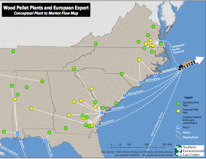

The United States was the largest exporter of wood pellets in the world in 2012 as demand for wood fuel increased sharply in Europe, the NDRC says.
As reported on a website for the North American Biomass Pellet Export Conference, wood pellets will help European countries meet their 20% renewable energy goals by 2020. Demand should hit 32 million tons by 2016 and rise to as much as 335 million tons a year by 2020.
“These manufacturers clear forests, grind the trees into wood chips and ‘wood pellets’ and ship them from ports in the Southeast to ports in Western Europe,” the group says. “Last year alone, wood pellet exports from Southern ports increased 70 percent.”
