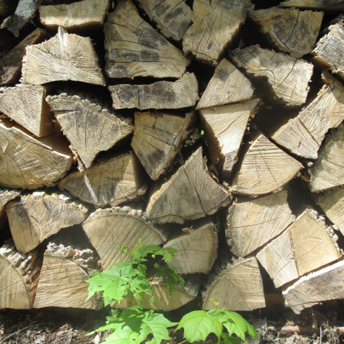

The fuel is carbon-neutral, but the smoke can be nasty. The particulates in wood smoke contribute to air pollution and lung disease.
Image Credit: Martin Holladay
Environmentalists often argue over the wisdom of heating homes with wood. Strong arguments can be marshaled on both sides of this debate, so I’ll do my best to represent both positions before summing up.
Burning wood makes environmental sense
According to wood-fuel advocates, burning wood is carbon-neutral. While burning wood releases carbon into the atmosphere, the carbon would have been released anyway if the tree had died of old age and rotted on the forest floor.
Here’s how a forest’s carbon cycle works: as trees grow, they sequester atmospheric carbon by converting CO2 in the air to leaves, twigs, and wood. The CO2 isn’t permanently sequestered, however, since virtually all wood (with a few exceptions, like Tutankhamen’s throne) eventually burns or rots. The amount of carbon released by burning is the same as the amount released by rotting.
As long as firewood is sustainably harvested — that is, as long as a logger limits annual cutting to the annual growth of the forest — burning firewood is carbon-neutral.
Wood-stove advocates also point out:
  • It’s better to buy firewood from a local logger than to buy oil or gas from overseas. Spending money locally strengthens the local economy.
  • Since firewood is usually harvested nearby, those who burn wood are less likely than those who burn oil or gas to experience unexpected disruptions in their fuel supply.
  • Wood stove technology is simple and robust. Wood stoves can keep a house warm when electrical service is disrupted — for example, during an ice storm.
  • Wood ashes are a useful soil amendment; they help raise the pH of acid soil and supply potassium, a necessary plant nutrient.
  • The environmental effects of firewood harvesting are more benign than the environmental effects of coal mining or oil and gas drilling.
