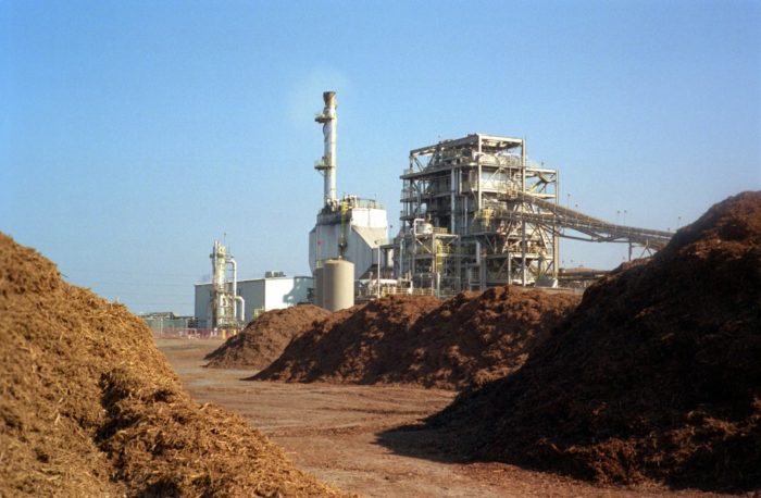

Biomass is a key part of government’s plan
The Environmental Protection Agency is counting on biomass to reach carbon dioxide reductions outlined in the Clean Power Plan (CPP). But, the letter from environmental groups argues, the premise is wishful thinking and burning more wood and other forms of biomass would actually violate the Clean Air Act.
“EPA and other agencies have often treated CO2 from bioenergy differently from CO2 from fossil fuel combustion, even though CO2 from both sources has the same effect on the climate,” the letter says. “This different treatment is based on the theory that burning biomass to generate energy either results in emissions that will be recaptured as trees grow back, or avoids emissions that otherwise would have occurred if the biomass were to decompose.
“However, even if emissions are reduced by regrowth later in time, or if emissions that would have occurred later in time are avoided, the offsetting reductions are significantly delayed — on the order of years, decades, or more than a century, depending on the material used as fuel.”
The groups said burning wood and other forms of biomass produces about 3,000 pounds of CO2 per megawatt hour of electricity, about 50% more CO2 than the emissions from a coal-fired power plant. Co-firing biomass in coal plants produces more emissions than burning coal alone and decreases the efficiency of the plant.
Environmentalists also criticized other parts of the CPP. They claimed that shifting the responsibility of accounting for carbon emissions from biomass to individual states without any guidance for how to evaluate it “would invite arbitrary results and would have no rational basis.” The EPA proposal, they said, would not require biomass plants to make sure that emissions reductions occur right away, or even within a specified time period.
Finally, they argue, the EPA’s concept of “sustainability” isn’t the same thing as accounting accurately for carbon: “Sustainability standards in the forestry context, however, generally do not consider carbon dynamics at all, and thus cannot serve as an accurate proxy for carbon accounting.”
“The organizations represented on this letter have a range of perspectives about bioenergy,” the letter said. “However, we all agree that the molecules of CO2 emitted by biomass-burning facilities warm the atmosphere and acidify the oceans just as effectively as CO2 from fossil fuels.
“Even if bioenergy emissions are eventually offset, the process of reaching net emissions parity with coal- and natural gas-fired power plants takes decades to more than a century, depending on the feedstocks used and the combustion efficiency of the facility.”
