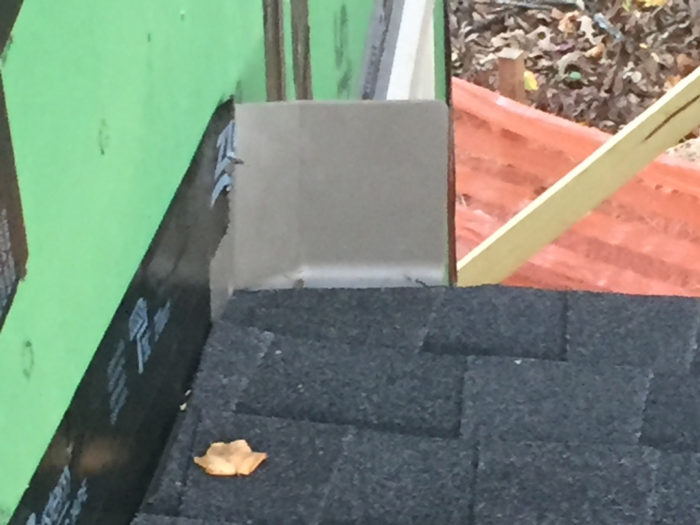

One nice detail I was able to incorporate was manufactured kickout flashing at the roof/wall intersections. I used a product called DryFlekt, preformed out of TPO membrane. The flashing comes in both right-hand and left-hand shapes, and is perfect for keeping that pesky water out of walls.
Kickout flashing is a very important detail that far too many builders miss or ignore. When we are certifying homes it is one of the most frequently overlooked items, often taking weeks or months to get installed, holding up the certification process.
