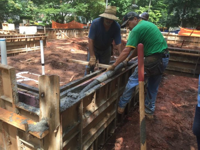

Image Credit: All photos: Carl Seville Foundation walls were filled with aggregate made of recycled crushed concrete. Workers installed 1-inch XPS foam vertically at the edge of slab; they also installed a 24-inch-wide strip of horizontal 1-inch XPS at the slab perimeter, before the polyethylene and steel were placed. The foundation is ready for the slab pour. The insulation, poly, and steel are in place. The Polyguard Term termite barrier is being applied under the wall plates. The remainder of the floor will be covered after the house is dried in. Caulk-type sealant is applied around holes in the Term barrier to make it a continuous termite barrier.

The main house foundation consists of stem walls ranging from 2 to 3 feet high, filled with recycled crushed concrete aggregate, with a slab on top. I’m not a big fan of crawl spaces, and in this case, I would have had to excavate well below the existing grade to have adequate clearance. This would have required a major waterproofing effort as well as installation of a dehumidifier to condition the space. The slab option looked a lot better to me.

Starting with a strong foundation
I installed Owens Corning 1-inch XPS board around the perimeter of the slab and below the slab, 24 inches wide around the perimeter. This should give me all the insulation I need in Climate Zone 3, where it rarely gets very cold.
