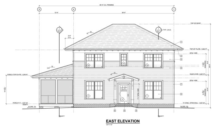

Image Credit: Thomas Bateman Hood Architecture The extensive lot coverage will require most of the paving to be pervious. At the rear of the lot, we have also included a rain garden where most water drains to. Note the sheathing on top of the second-floor ceiling joists, providing a solid air barrier with no penetrations. I will be able to test the house for air leakage before any drywall is installed. OK, critics: let's hear your complaints about the design.

First, I am going to avoid spray foam insulation, and limit foam board as much as practical. I will be using Owens Corning spray-applied fiberglass in the exterior walls and on the attic ceiling. Exterior sheathing will be Zip-R with an R-3 polyiso layer. I considered using mineral wool for the exterior thermal break, but the added thickness and complexity of construction led me to the combined sheathing and insulation product.
I am going to use a passive-house type of detail on the top floor ceiling. The Zip sheathing will be installed on top of the ceiling joists, taped to the side wall sheathing, provide a complete air seal on top of the joists, instead of relying on the ceiling drywall. HVAC will be ductless mini splits from Mitsubishi, eliminating any ducts in the attic area.

unvented attic
The choice to vent your attic maybe because of Dekalb's building code. I would like to know what are your thoughts on venting or not venting your attic. Mr Joseph Lstiburek has given his view point. If you were to go with an unvented attic might give you a hedge against all those pesky critters that like to call your attic home. You made be far enough south to put a hot water tank heater in an unvented attic. Being a raider from Decatur, I salute you for your good articles.
Attic
I'm doing a vented attic because I will have no ducts and will not be using spray foam. It will be similar to a traditional attic. Nothing to do with the new Decatur ordinance.

Air tightness target?
With your 'service space' separated from the vented attic, you should be able to hit an excellent air tightness number.
Do you have a target in mind?
Excited for you! Quick question.
With regards to the slab. I didn't see a layer or poly between the foam and concrete. Will there be one?
I'm excited to hear about ZIP-R. I've seen ZIP going up around Atlanta on apartments and SFD.
Air leakage and poly
I'm not a fanatic about air leakage. I expect that I will be in the range of .15 envelope leakage ratio, or around 1.5 ACH50. May end up tighter. Yes there will be a layer of poly under the slab, on top of the foam board. Will definitely be posting about it. Regarding the Zip R, I'm excited to see how the continuous insulation performs as well.

Zip-R perm value
Hey Carl.
Congratulations on your new build. Do you have any concerns about the low perm value (<1) of the R panel? It won't dry to the inside, correct. So it will have to dry to the exterior if any moisture penetrates into osb.
With ZIP-R the OSB always dries toward the exterior.
With the 1/4" rainscreen spelled out in the wall detail, the OSB should have no problems drying toward the exterior:
https://www.greenbuildingadvisor.com/sites/default/files/Sections.jpg
The proprietary weather resistant barrier coating on all ZIP products means that bulk water wicking into the OSB would always be minimal, and with any rainscreen at all the amount of exterior moisture blowing by the clapboards reaching the ZIP would also be minimal, and offers an inimpeded drainage & good drying path for both the siding and the ZIP.
Thanks Dana
I have been traveling all day and wasn't able to respond to Steve's question. As Dana, said, the combination of the weather barrier on the Zip and the vented rainscreen will provide any necessary drying of the sheathing, as well as help limit any vapor drive from the exterior.
