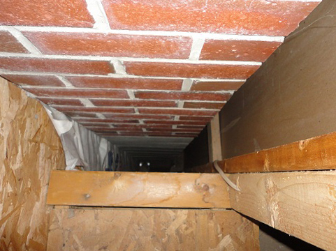

Secondly, “major thermal bypasses” is building-geek speak for holes in your house — holes through which you are losing an abnormal amount of heat. More formally, they are areas in standard construction where flaws in the building enclosure allow air to escape, bypassing the thermal control layer.
