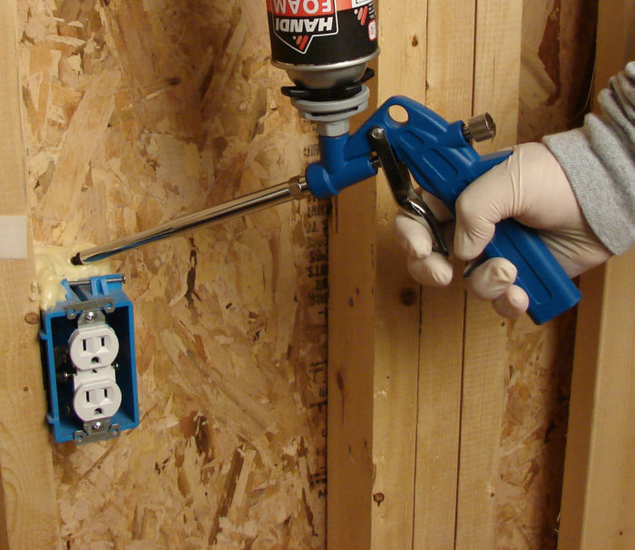

Love the article, but the picture of the outlet on the exterior wall kills me! Best thing I ever decided was to remove all wiring, venting or any other service except those very few that are absolutely necessary in the exterior walls. Brass (yes they are expensive) floor outlets work great and were easy to install. I put the minimum required by code in and then peppered the interior walls with regular outlets as required. 2nd best thing I did was to make drywall continuous on the exterior wall. Interior walls butt into the drywall. Got my house http://rosedalehouse.ca down to 1.6ACH. Not bad for an historic, therefore interior only retrofit project . I believe the historically "correct" double hung windows are my downfall. Look good, but leak like hell!

In a well-designed house, there is no need to avoid or skimp on electrical outlets in exterior walls, and few owners are going to be happy with floor receptacles. Proper planning and proper air sealing is no harder to do than any other air barrier detail. And running exterior wall drywall continuously behind (and above) partitions, requires a two step drywall and rough wiring process that few builders or subcontractors would tolerate, and still requires penetrations for wiring which have to be sealed. Proper ADA techniques makes sealing at partitions just as effective and keeps the construction sequencing on track.
