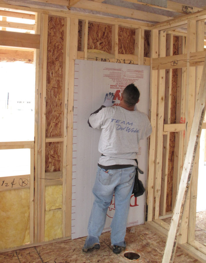

Insulate and seal — before the plumber shows up. Before installing a tub/shower unit against an exterior wall, Energy Star builders are required to insulate the wall and to install an interior air barrier over the insulation.

    I've always wondered, it the point is to enclose the insulation on six sides, why you can't just blow the area between the fiberglass shower and the exterior wall completely full of insulation? Do you know what that rationale is? Easy enough for us to hold on setting the tub until after the insulation since we're plumbers but just curious.

    It sounds like you are proposing using the fiberglass tub/shower unit as the interior air barrier.
    The main problem with such a suggestion is the lack of air barrier continuity from the tub/shower unit to the rest of the home's interior air barrier. For example, if you blew insulation behind the wall of the tub/shower unit, the insulation would also extend under the tub. Any air leakage under the tub would communicate with the walls.
    You would need to have a very carefully detailed plan to be sure there was air barrier continuity between the edges of the fiberglass unit and the rest of your interior air barrier (sheetrock, plywood subfloor, whatever).
    Finally, there's that massive hole in the subfloor for the tub drain and overflow fitting and the trap. More air-sealing details required there...
