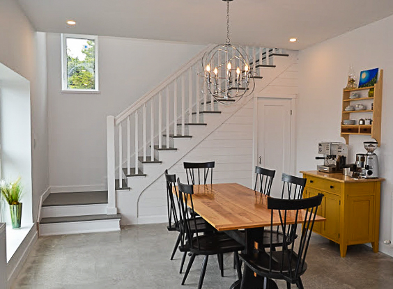

The dining room is bright and spacious. The staircase was the author's first. Its simple details complement the furnishings in the house with a modern traditional theme.

The dining room is bright and spacious. The staircase is exactly as I had envisioned. My father and uncle helped with the installation. Although it was the first staircase I ever completed, I have quite a bit of woodworking experience so I saw it as a challenge. The simple spindles and skirts and treads go well with our simple furniture and fit nicely with the modern traditional theme.
We integrated a shelved pantry under the staircase which is accessible by a small door. I sheathed the wall under the stair skirt with shiplapped boards. We felt this treatment added to the theme and also broke up the expanse of white walls. We decided to go with white (“Chantilly Lace” from Benjamin Moore) throughout the house and I am glad we did. Even on the darkest of days, there is enough light bouncing around from the large south-facing windows that we rarely have to turn on any lighting.

    We played with the window quite a bit. It looked odd extending it down too far. THis being said, if I had left the staircase as a winder, I think people could have seen out the window. THe original plan called for 16 risers and a winder staircase, to make things simpler I opted for 15 risers and built in a landing. It was the first time building a staircase and I was already intimidated by the task. By the end of the current landing, people walking up the stairs would have been 4 stairs up and could have seen out the window. This being said it adds great light to that stair case.
