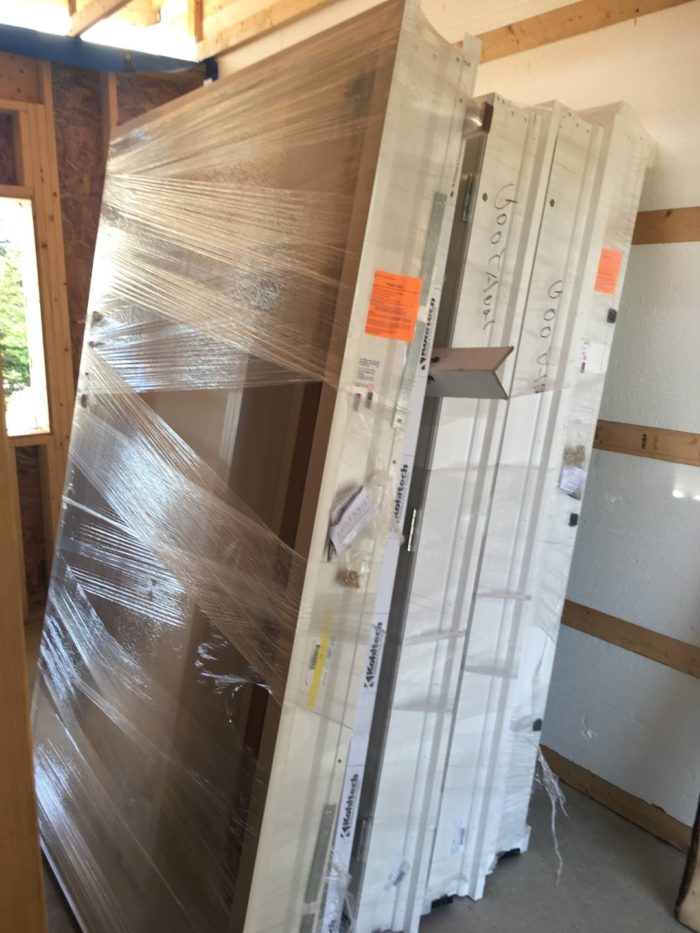

And now the doors
The doors that I ordered were pretty much the best Kohltech offers. The door frame is made of cellular PVC so there will never be any real maintenance issues. With vinyl-clad wood jambs, there’s some risk of the wood rotting over time. The door slabs are fiberglass.
In the front of the house we opted for a half-glazed door since there are no windows in the main entry. On the porch, a half-glazed door allows some natural light to spill into the house. The south side of the house has a door with full glazing. All of the glazing on the doors is triple-glazed Energlas Plus (high solar gain on the south side, low solar gain on the north) corresponding to total door R-values of about 5. The company doesn’t really provide any information about how this is measured but I assume it’s at the center of the door since they list different U-factors depending on glazing coverage. For example a door with no glazing has an imperial U-factor of 0.16 but one with full glass has a U-factor of 0.21.
I am sure Kohltech would provide the information if I were to investigate further…. and I will investigate further. I ordered the doors with triple-point locking hardware (see Image #5 below) in hopes that minor installation issues would still allow tight-fitting seals around the doors when the triple-point lock is engaged. R-value isn’t everything. A leaky door is as good as an open one. All the R-value in the world won’t keep your house warm with an open door in the middle of winter.
Installation is straightforward
Kohltech’s instructions for door installation are fairly typical. We applied a couple of thick beads of acoustical sealant on the sill pan and 6 inches up the door jamb. From the outside we tipped the sill of the door onto the sill pan of the rough opening and centered it approximately. We then tipped the door in place so the back of the vinyl brickmold was flush with the exterior. We made further adjustments to the centering of the sill so when the jamb was level, the door box had an even spacing with the rough opening all the way around.

The triple-point Trillium locksets are nice, and come preinstalled. This set is nickel-plated. There are three strikers and three latches, all of which are controlled by a single lever and a single deadbolt knob. The deadbolt is quick-release from the inside. If you need to exit quickly you need only to push the door lever downwards and it releases the deadbolt lock. As you engage the lockset deadbolt you can see the upper and lower parts of the door pull towards the weatherstripping. I am hoping this means a tighter seal and less issues the door air seal if it ever warps, since the locking mechanism will pull the door shut.
One issue with using shims is how to air seal around them. There is no real elegant solution here. You really need the shims for support, but they get in the way for air sealing. My solution is to back-cut the shims on a slight angle from the rough opening towards the door. I will spray foam and apply backer rod between the rows of shims and then caulk the face of the back-cut shim so that no air can leak through… and then I’ll cross my fingers!
