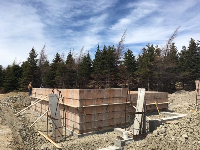

Adding the frostwalls
Since the home design has been completed, I’ve been studying the drawings over and over again. Every couple of days I come across an interesting conundrum. This one is a tale of two foundations.
One of the principles of Passive House design is building an efficient envelope that is superinsulated, airtight, and thermal-bridge-free. If a foundation in a cold space is joined to a foundation in a heated space there are several potential issues. First, it provides a short circuit for heat to travel outside of the thermal envelope during heating season and for heat to enter the envelope during cooling season. This also could lead to interstitial condensation in the walls, promoting mold issues inside the wall at the junction of the short circuit. To minimize this transfer, the designer wanted to separate the thermal envelope of the house from the porch using 2 inches of EPS foam.
Because of the way the forms are connected it would have been possible to insert a piece of foam at the connection between the two foundations. However, once the concrete was poured there would be no guarantee the foam would stay in place. Additionally, there would be no way for the two foundations to be connected. So is there a way to do this using fancy Passive House materials? Probably. However, I had to work with what I have.
Our solution was two pours. The house foundation was poured first. The following day, the forms were removed and a piece of foam 8 inches wide was glued to the foundation at the point of connection between the two walls. We drilled holes through the foam and into the newly hardened concrete, then glued rebar into the holes with epoxy. The forms could then be set up and the concrete for the second foundation poured. The rebar makes a semi-rigid connection between the two foundations.
Calculating energy losses of thermal bridging
Is there an energy penalty for using rebar? There definitely is! It is a thermal bridge directly into the foundation. But since the heat flow is proportional to the area, one would expect the cross-section for several pieces of rebar to be much less than the area connecting the two walls.
Using some highly simplified assumptions, I determined that using the rebar has an energy penalty about 14 times less then leaving the concrete connected; it’s safe to assume the energy lost is about an order of magnitude less when using the rebar. Using data found online, I calculated the power lost through the rebar could be as high as 0.5 W/ degree C. So a temperature differential between the outside foundation and the inner foundation of 15° would mean an energy loss of about 7.5 watts. With the concrete walls joined together, the power lost through the wall would be about 9.2 W/ degree, equating to about 140 watts. Assuming the temperature differential between the foundations is at least 15°C for one-third of the year, this equates to almost 400 kWh of energy, or about $40 on my electricity bill.
This is significant and has a short payback for the time invested. But keep in mind there are a lot of assumptions here. The total energy savings is really still a question left up to energy modeling. But for the cost of rebar, epoxy, a masonry drill bit (about $70), and some minor inconvenience associated with doing two pours, I figured it was worth it.
