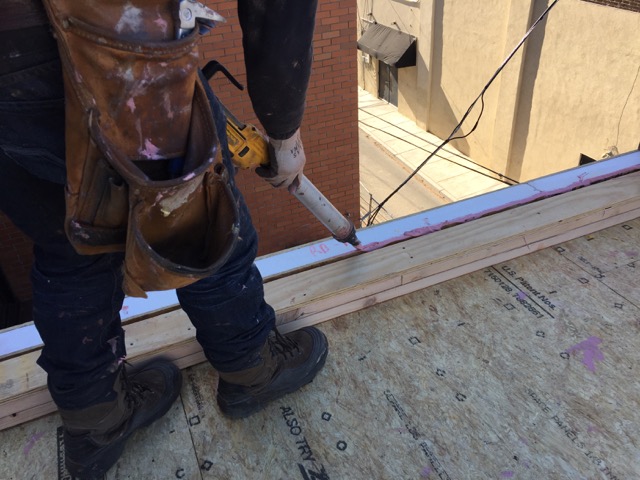

A critical part of the assembly is making sure you get the air barrier all sealed up. In this case, the primary air barrier is the OSB in the middle of the panel. The photo at the top of the article shows a worker installing sealant (Prosoco’s R-Guard Joint & Seam Filler) with a sausage gun.
The water-resistive barrier (WRB) is Zip sheathing and that gets sealed up, too. Huber makes both a tape and a fluid-applied sealant for the seams, and Build SMART recommends that builders opt for the fluid-applied sealant. You can see in the photos that McDonald followed their advice.
