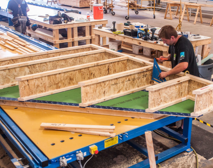

Reefer racks up the pieces one section at a time, and when he’s done the rack goes to the assembly area where two other carpenters are putting the pieces together. The “framing table” where the components are assembled will soon be equipped with multicolored lasers projecting lines on the work surface to guide placement of the pieces precisely.
Layer by layer, the pair builds a wall component, beginning with the 2×4 structural wall, followed by the taped sheathing, the I-joists, the Mento Plus membrane, and finally the rainscreen. Framing tables come in pairs, called butterfly tables, that allow carpenters to flip an assembly over by simultaneously tilting two tables together like leaves of a book (or butterfly wings) until nearly upright. A wall assembly can then be transferred onto the facing table and lowered, allowing carpenters to work on the opposite face.
On the day of the tour, Ecocor wasn’t producing roof panels, but the “Super Roof” panels are made essentially the same way as walls. They start with rafters made of dimensional lumber, followed by sheathing, and I-joists filled with cellulose. R-values vary depending on requirements of the climate zone where the house will be assembled.

The walls are rugged
Farhoud, the walls are built more or less conventionally, with 2x4 framing and ZIP sheathing. What is your concern about racking? The TJI's they install on the exterior are only supporting insulation and siding, and have excellent lateral stability. (I used to work there so I know the system pretty well.)
Strapping
Is the horizontal strapping necessary to stabilize the TJIs, or is it sometime eliminated depending on the siding?
Horizontal strapping
Malcolm, the two layers of strapping allow for some "poofing" of the WRB while maintaining at least a 3/4" drainage plane. As tight as they pull the WRB, the dense-packed cellulose pushes it out a bit. When the siding is horizontal they reverse the orientation of the two layers of strapping. The TJI's are very rugged; there is no lateral movement.
Thanks Mike
It looks like an excellent system
