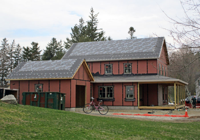

Last fall, Dartmouth College realized that it needed to build four new single-family homes, pronto. Beginning this summer, the homes will be occupied by the “house professors” assigned to new “house communities” — the term that Dartmouth uses to describe the college’s dormitory clusters.
To build the four needed houses, Dartmouth hired Unity Homes, a company in Walpole, New Hampshire, that assembles homes from panelized walls and modular components. Founded by Tedd Benson, Unity Homes specializes in superinsulated buildings with very low rates of air leakage. (For more information on Unity Homes, see the links in the “Related Articles” box below.)
My son Noah, who’s a junior at Dartmouth, noticed the new homes under construction and tipped me off. So I drove to Hanover, New Hampshire, to check out the new buildings. Tim McNamara, Dartmouth’s associate director of Campus Services, graciously met me at one of the job sites. I was given a tour of the sites by three representatives from Unity Homes: Ryan Lawler, Justin Pouliot, and Brad Moore.
Panelized walls and modular bathrooms
Although Unity Homes is expanding, it only sold 12 homes last year, so it’s still a relatively small company. At its indoor manufacturing plant in Walpole, Unity Homes assembles building components into wall panels and bathroom modules. (Bathroom modules are shipped to the job site with the tub, vanity, sink, and wall-hung toilet already installed. Once these modules arrive on site, they are moved from the truck to their final location by crane.)
Unity Homes is convinced that its German-made CNC (computer numerically controlled) cutting machine and its focus on indoor assembly helps the company achieve a higher standard of construction quality.
Unity has developed a panelized wall system using 9½-inch I-joists…

Sill flashing
I'm not sure trying to move bulk water to the exterior at the window sill is best done by sandwiching membrane between two layers of siding.
One of the reasons to include a rain screen is to provide a drainage cavity, and typically all flashing is kept on top of it so that any water that does penetrate the siding can move unimpeded to the bottom.

I understand your point. I think this detail is debatable -- but in the long run, either way works.
Most people overestimate the volume of liquid water that a rainscreen needs to handle. In most cases we are talking drops, not tea cups. The main way this water disappears is evaporation, not drainage. So the skirt flashing on these homes, though unconventional, probably works fine.
Martin
I agree, and it's a very minor detail among what are very well built houses. It's just an unnecessary complication.

I agree that the flashing would be fine without the detail shown, but I am used to seeing flashing that either just barely works, doesn't quite work, or doesn't even come close. So it's a breath of fresh air to see someone going beyond the minimum.
To underscore that I will note that Martin's pictures are not cherry picking. I saw one of these in person and the details are carefully and consistently done throughout the house.
Martin, nice to hear that my one reservation (XPS) is being addressed.
Charlie
They sure look well thought out. Back to the skirt flashing though: If it isn't really going to deflect bulk water intrusions, then I can't see why it's necessary. If it is, then the chances are it will cause the water to pool where it is sandwich between the pieces of siding. Cement board doesn't allow much drying through the material, so you now have an area which has been identified as potentially problematic that is closed off from the ventilation and drainage the rain screen cavity provides. I think no flashing would be preferable.
