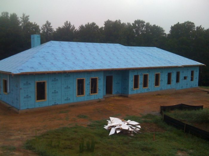

While working as an exhibitor at one of the local green building events, we met a fascinating couple who wanted to build a LEED Platinum home. Finally – our chance to run. What made it better: this couple had a mission to build their green house for an average cost. We were very excited to work with this couple and really liked the fact they had an alternate purpose to building a green home.
So we got a project team together and started working on the specifications. This project got under way right after the National Green Building Standard had come out. We recommended doing that certification as well as LEED for Homes — in order to compare the two rating programs — and they were up for it.
While working through the checklists for the two certifications, we learned about the DOE Builder’s Challenge. We all liked the fact that the house must score below 70 on the HERS Index — other green building programs don’t really insist on a target HERS number — so we thought this would be a good thing to shoot for as well. We were really running now!
Reconsidering advanced framing
After conducting a few energy audits, I had a new appreciation for advanced framing. As we looked at what we thought were well-built homes, we were shocked at how cold the studs were during the winter months in some of the houses we visited. We immediately knew that we needed to improve our thermal envelope and reduce thermal bridging.
We spent a lot of time looking at cost-versus-value on the thermal envelope. We finally decided on 2×6 wall construction, 24 inches on center, with blown-in insulation, rigid foam sheathing, and radiant barrier roof sheathing.

While looking at Dow Structural Insulated Sheathing (SIS), I saw that the perm rating was under 0.3. This worried me – it appeared that everyone in the green world recommended exterior foam as a thermal break, but this meant installing a vapor retarder on the outside of your wall. We had always learned from Fine Homebuilding and BuildingScience.com that in our climate you don’t want to have a vapor barrier in your wall; you want to allow the wall to dry in both directions. This is opposite of everything we had learned over the years.
Well – I went to my favorite website, GBA, and asked them what they think. The site proved to be a great resource, and I had some great discussions and received good advice. I also asked several other questions on the site as well — we had moved to a high-performance felt as well, but that too was putting a vapor barrier on our roof which concerned us. But after speaking with the experts at GBA, we felt much more comfortable about where we were headed.

We had a great verifier and the construction process went very smoothly. It was nice to have the homeowners so involved in the process – we felt like it was more of a team approach rather than us working for them. All inspections went well and when we ran our blower-door test, we got the lowest reading our verifier had ever done. We ended up with a HERS Index of 52, and the house was built for $126 per square foot. We felt like we had accomplished all of our goals.

I do not recall the CFM50 off the top of my head - will have to track down my notes. I think it was under 500.
Air controls layers. Floor was the conceret slab. Ceiling was Sheetrock. Exterior walls both the Sheetrock and the DOW SIS.
Blown in was Climate Pro Blown in Blanket System with netting:
http://www.jm.com/insulation/building_insulation/products/bid0019_climatepro_bibs.pdf
The density of this was 2.3 lbs/cubic foot so did not qualify as our air barrier but did get us an R-23 in a 2x6 wall plus our R5.5 from the 1" of DOW SIS.
Initially we were going to do an unvented roof but our owner did not want to use spray foam and we were having a hard time coming up with a way to get our required air barrier below the insulation in a cost effective manner. We consulted with our rater and he told us we actually had a lower HERS with the thermal envelope being at the ceiling level due to the increased surface area having it at the roof. We decided our best value and lowest HERS was R-38 blown in at the ceiling and radiant barrier roof sheathing. We were a little disappointed that we were then putting our HVAC unit and all duct work in the vented attic. To address this issue we built a conditioned room for the unit to go in and extended our thermal envelope up into the attic for this one section. Figured the unit itself was more important than the duct work. We then used the radiant barrier sheating to make up for the duct work being in the vented portion of the attic. We framed this house in the summer and was really impressed with how well the radiant barrier sheathing worked. Our HVAC installers liked it so much they turned a one week rough into a three week job.
