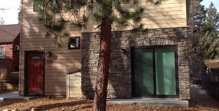

![](http://images.greenbuildingadvisor.com/app/uploads/2018/07/24232013/Turner%20-%20Exterior%20elevation%20-%20photo%204_0-main.jpg)
Image Credit: Stu Turner I used SketchUp and Google Earth to model the exact shading at any time of day and any day of the year.

A high-performance design for the mountains above Los Angeles
A few years into the housing bust, I started shopping around for a cabin to use as a getaway and vacation rental. I live in San Diego and I set my sights on the resort town of Big Bear Lake, in the San Bernardino mountains northeast of Los Angeles. Just 2½ hours away, it was a place where my family and I had spent many weekends skiing, snowboarding, mountain biking, and fishing.
During a leisurely on-and-off property search, I found several deals, but was generally underwhelmed by the quality of the housing stock from an energy perspective. Even the newer homes were of “barely legal” code minimum construction, and winter heating bills north of $500 per month were not unusual.
This was shocking to me, perhaps because my own mild coastal climate has a meager 1,200 heating degree days (HDD) and 1,000 cooling degree days (CDD) per year. I typically use my furnace intermittently for a few months a year, and I don’t even own an air conditioner. Or maybe my expectations were just too high because my only exposure to cold climate construction came from reading Green Building Advisor!
Eventually, I started exploring the idea of building a house, but I soon learned that the going rate for new custom home construction (about $250 per square foot) was out of my price range. Things changed when I discovered several GBA articles about cost-effective, energy-efficient construction – most notably PostGreen’s 100K house, Eric Thomas’s house in Seattle, and Carter Scott’s work in Massachusetts. These case studies inspired me to pursue the project as owner/builder.
Outdoor temperatures can drop below zero
In the summer of 2013, I found a great deal on a bank-owned 50 ft. x 100 ft. lot with decent southern exposure, and set about designing the house. At this point my goal was to create a “Pretty Good House” that hopefully approached net zero energy use.
At an elevation of 6,800 feet, Big Bear has an alpine climate with 6,600 HDD and a Manual J design temperature of -7°F. Yet it also boasts over 300 sunny days a year, and is even home to a solar observatory constructed by CalTech in 1969.
I eventually settled on a simple rectangular two-story shape, sandwiched between a huge oak in the front of the property and a small stand of pines in the rear. The design featured 2,200 square feet of conditioned space, with 3 bedrooms, a loft, 2½ bathrooms, and an attached one-car garage.
After performing some heat load calculations, I was confident that two minisplits could meet the heating demand, assuming a “pretty good” level of insulation and decent air sealing. With the help of a local architectural engineer, I soon had a minimal set of plans approved by the city.
“I never heard of that”
One of my biggest challenges (in addition to my own lack of time, experience, and money) was finding subcontractors and materials to implement the energy-efficient aspects of the design. For example, after weeks of calling around, I was unable to locate a company that could blow dense-packed cellulose into the framed walls. I guess in the land of R-13 walls, there isn’t much demand for these installations.
Finding a dealer of high-density below-grade EPS was an arduous task. But after working with a manufacturer’s rep, I was able to find a local building supply company that special ordered it for me.
My framing sub was excellent and open-minded. I tracked down Rob after reading about his involvement in the construction of a local SIP house. But his crew had never heard of building gaskets, Zip sheathing, blower door tests, double-stud walls, or textured housewrap. In Southern California, this would have been the case with any contractor, except for a few specialty builders.
So at every step of the design process I had to balance what I wanted to do with what materials and services were readily available.
