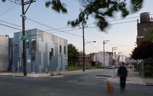

![](http://images.greenbuildingadvisor.com/app/uploads/2018/07/26163545/100k%20complete-main.jpg)
Image Credit: Sam Oberter Photography for Postgreen
Construction costs for developer Postgreen’s flagship project, the 100K House, came in at just under $100,000. The 1,150 sq. ft. home is aiming for LEED Platinum certification
