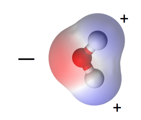

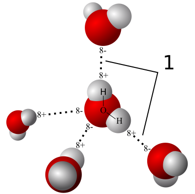

Let’s begin with the water molecule. One oxygen, two hydrogens, bonded together covalently. That means each hydrogen shares its one electron with the oxygen atom and both atoms get to complete their outer shells by doing so.
[Image credit: Wikimedia Commons]
As it turns out, the oxygen atom pulls on that shared electron from each hydrogen atom more strongly than the hydrogens do, so the oxygen side of the molecule is slightly negative. The hydrogen ends are thus slightly positive. Because the water molecule is bent (as opposed to linear, with the hydrogens on opposite sides of the oxygen), the molecule is polar. It has a negative end and a positive end. The positive charge is concentrated in two areas near the hydrogen atoms, as you can see in the illustration at left.
When you put a bunch of water molecules together, the polarity of the individual molecules causes them to attract each other. Like charges repel and unlike charges attract. As you see above, each water molecule can form weak bonds, called hydrogen bonds, with four other water molecules.

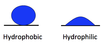

The polarity of water molecules means that when you put it in contact with another material, what happens depends on which attraction is stronger: water for itself or water for the other material.
When the water is more strongly attracted to itself, as you see on the left side of the diagram at left, we call the other material hydrophobic, or water fearing. When the water is more strongly attracted to the other material than to itself, we say that material is hydrophilic, or water-loving.

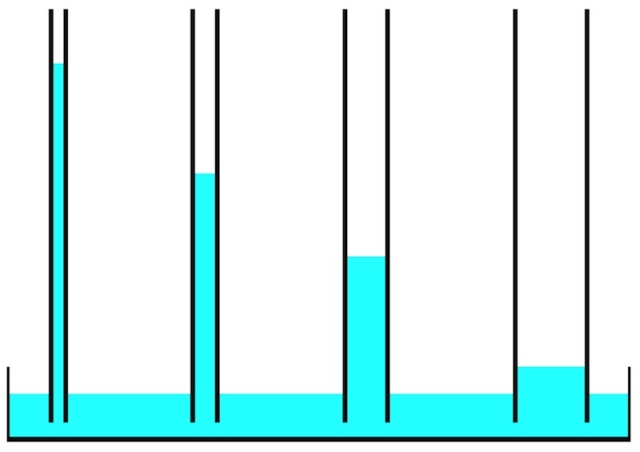

If a porous material has one end sitting in water, the pores, or capillaries, will begin filling with water. The movement of water through capillaries depends on how hydrophilic, or wettable, a surface is and on how small the capillary is. The smaller the capillary, the higher the water can rise in it, as you see in the illustration at left.

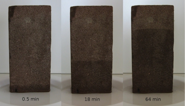

The photo of bricks below shows the capillary rise of water over time. After a bit more than an hour, the water is three-quarters of the way up the brick.

How high can the water rise? I said at the beginning I was going to do this article without equations, so I’ll just tell you that there is one you can use to calculate the height a column of water can rise in a capillary. It depends directly on how wettable the surface is and inversely on the radius of the capillary, the density of the water, and the acceleration due to gravity. (If you want to see the equation, go to the Wikipedia page on capillary action and look for the section titled Height of a meniscus.)

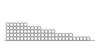

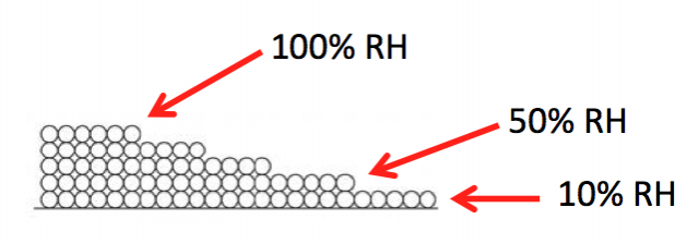

Another word you need to know here is “adsorbed.” Those monolayers of water that stick to the surface are the fourth state of water. Here’s why.
When that first monolayer of water molecules begins sticking to the surface, it does so with gusto. Remember, we’re talking about hygroscopic materials that can pull water vapor from the surrounding space. They really like each other!
The second monolayer is also attracted strongly…but not as strongly as the first monolayer. Since the second monolayer is attracted to the surface through the monolayer of water that’s already there, the attraction is muted a bit. Likewise with the third, fourth, and fifth monolayers.
[Image credit: Building Science Corporation (with modification by Energy Vanguard)]
The diagram at left gives you a picture of that weakening attraction. The first monolayer is complete when the relative humidity rises to 10%. The relative humidity then has to rise to 50% before the second monolayer is complete. As the relative humidity keeps rising, the monolayers keep increasing and hit five by the time you get to 100%.

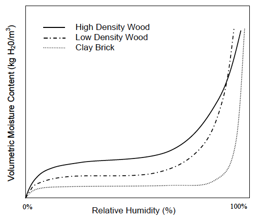

Now we can put all this together and understand what’s going on in these geeky things called sorption isotherms. The graph below, taken from Professor Timusk’s doctoral thesis, is a good example.
[Image credit: Professor Chris Timusk]
First, let me point out that there are three curves here: two for different densities of wood and one for clay brick. Each one shows the moisture content in the material as a function of the relative humidity of the surrounding air.
Notice that each curve exhibits the same pattern: a rapid rise, a flattening out, and then another rapid rise. Recalling the explanations above for adsorption and the three types of moisture transport, what do you think is happening in those regions? See if you can figure it out before going on to the next paragraph.

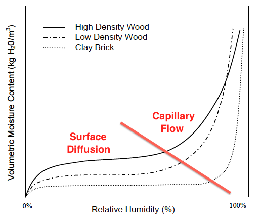

Well, first off, the curves show surface diffusion and capillary flow. We know capillary flow starts at higher relative humidities, so the initial rise and the flattened out part are where surface diffusion is happening. But why does the initial rise flatten out so quickly?
Recall that the first monolayer feels the strongest attraction for the surface. It gets filled at about 10% relative humidity. The flat part of the curve is mostly filling the second monolayer plus a bit more in wood and significantly more in brick.
When the curves shoot up again, capillary flow has kicked in (see graph below). Now the moisture content can increase rapidly with increasing relative humidity. And here’s where we can see something really interesting about the difference between materials.
Notice that capillary flow doesn’t start in the brick until the relative humidity is much higher than in the two types of wood. Hmmm. What could cause the capillaries not to fill up at lower relative humidity like it does in wood? Why of course. It’s because they’re bigger!
