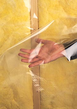

STEP 9: INSTALLING VAPOR RETARDERS
Code: R601.3 Class-I or -II vapor retarders are required on the interior side of framed walls in zones 5, 6, 7, and 8 and in Marine 4, except on basement walls; in the below-grade portion of any wall; and in construction where moisture or frozen moisture will not damage the materials used in the assembly.
What it means to you: Since the last edition of the IRC, the vapor-retarder requirements in the IECC, IRC, and IBC were changed based on an understanding of building science. This change moves the new vapor-retarder requirements into their proper code
location because they are more reasonably related to the building shell. This means that in the prescribed zones, you’ll need to install a vapor retarder on the interior side of a wall. A class-III vapor retarder can be used in lieu of class-I and -II products in some cases when the cladding is vented or insulated sheathing is used. This code, which was previously only part of the IECC, is now integrated into the IRC.
