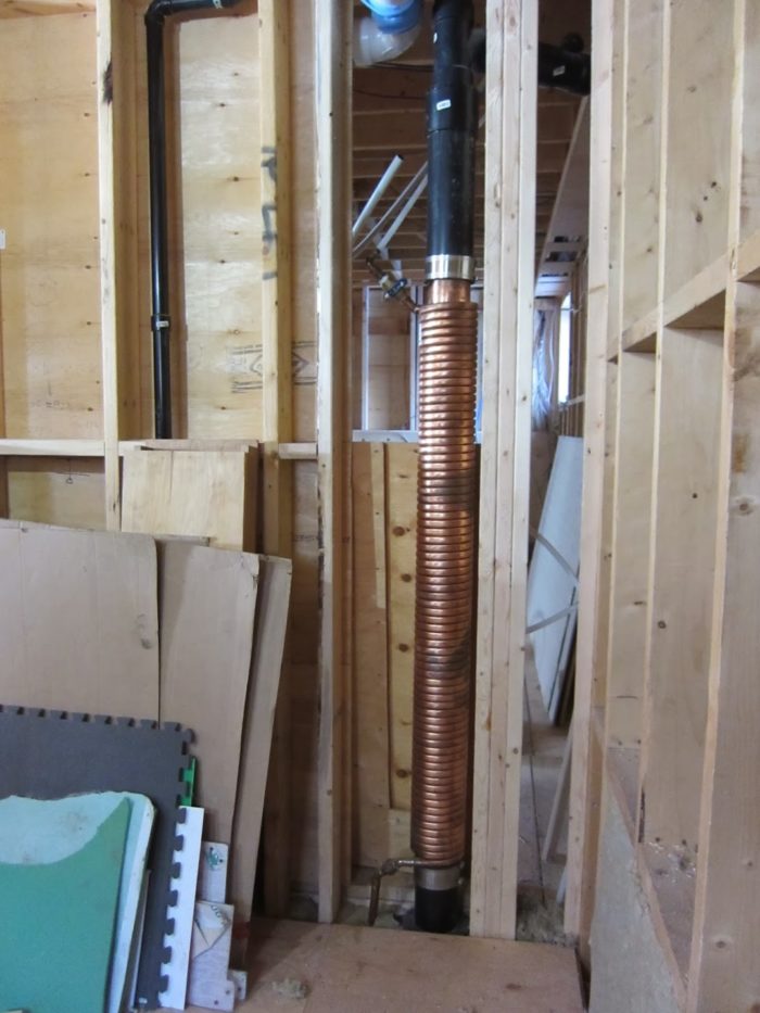

Installation
You can see there is a lot of copper in these things. The one we installed was a good 60 lb. We came up with a simple way to mount the item effectively. We used a 4-inch water closet flange. We removed the small groove inside this flange so the 4-inch ABS pipe could be passed right through. This is basically creating a bulkhead fitting on your pipe, but there is no break in the pipe. Glue it on with solvent, and then mount it to a couple of wood runners, which make good supports. Notice also we’ve installed unions around the exchanger. This will let us more easily check its insides from time to time and clear out any build-up.
Water pressure losses
Something not mentioned very often: What about the pressure losses? The unit we chose to install uses a single 3/4-inch copper tube (about 60 feet of it) wrapped around the 4-inch drain. In choosing a product, it is a matter of heat exchange performance and this is measured by the Canadian government testing apparatus. After finding units that perform well, we looked for designs that retain the most water pressure.
So, how to plumb in order to retain water pressure? If you have high water pressure, this may not be an issue, but keep in mind, water pressure is not free. Someone, somewhere, must provide it, and I feel we must always think of our buildings as off-grid, so we want to minimize energy losses at every opportunity. Therefore, buy a unit that performs just as well, but results in the least pressure loss. Then, I would plumb everything through it. After all, we heat a lot of water to just room temperature via space heating — it sits there in the toilet, in the pipes, etc. But to recover that heat using the drainwater heat exchanger, the cold side must flow. Therefore, as per manufacturer recommendations, just plumb everything through it. I would still provide a small line to a drinking water fountain or ice maker, however.
