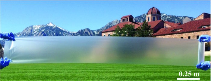

A metamaterial film that provides free cooling*
The peer-reviewed journal Science has an article with a convoluted title, Scalable-manufactured randomized glass-polymer hybrid metamaterial for daytime radiative cooling, but a simple message. The researchers have developed a material that can radiate heat away at night and during the daytime. And it does so with an impressive capacity.
The photo at the top of the article shows the material, a translucent film. It’s basically a plastic film with tiny silicon dioxide spheres embedded in it. (Silicon dioxide is the main component of a lot of the world’s sand.) The spheres play a critical role in tuning the material to emit infrared radiation while not absorbing any of solar radiation that hits the material during the daytime. The paper goes into the the physics, including a discussion of phonon-enhanced Fröhlich resonances of the microspheres and extinction cross-sections, but I’ll let you read you that those details if you choose.
The film and microspheres, together called a metamaterial, make up one part. It doesn’t absorb solar radiation, instead letting those electromagnetic waves pass right through. So they put a reflective backing on the film to reflect the sunlight back out. That prevents it from heating up whatever is behind the film (which would be a building in our case).
What could turn out to be a really exciting discovery for the building community is their measured cooling capacity. They set up the film outdoors and measured how much heat it could radiate to the open sky. They used an electric heater to pump heat into the film and adjusted the rate to keep the film at the same temperature as the surrounding air. By adding just enough heat to keep the temperatures equal, the researchers say the “total radiative cooling power is therefore the same as the heating power generated by the electric heater.”
They did this experiment in Cave Creek, Arizona, in autumn. The solar irradiance at noon was more than 289 BTU/hr per square foot (900 W per square meter). Over three days, they found the cooling capacity to be:
- 29.5 BTU/hr per square foot (93 Watts per square meter) at noon
- 34.9 BTU/hr per square foot (110 W per square meter) over 3 days
That’s pretty amazing. What it means is that you could get a ton of cooling capacity (12,000 BTU per hour) with about 400 square feet of this film. A typical new house these days has a cooling load of about one ton per 1,000 square feet of conditioned floor area. It shouldn’t be hard to find enough roof area to get all your cooling needs met if this material turns out to be as good as it looks now.

I'd rather have the reverse
The similar concepts I've seen before attempt to do the reverse: block solar radiation, ideally by reflecting it, and transmit thermal radiation. Then you can have a surface beneath the film radiating to the sky while being protecting from incoming heat, including incoming solar radiation, and incoming convection from the outdoors. That allows cooling to below ambient temperature.
On the other hand, the way they tested this film, by keeping it at a temperature equal to the air temperature, illustrates that it would be difficult to use it to cool anything below ambient temperature.
