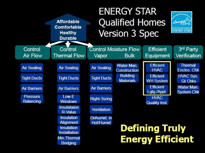

Beginning on January 1, 2012, homes enrolled in the Energy Star Homes program will need to comply with a new specification — dubbed Energy Star Version 3 — that is stricter than the current Version 2 specification.
Version 3 will still offer builders two possible paths to obtaining an Energy Star label: a performance path and a prescriptive path. Since it’s impossible to provide a comprehensive description of Version 3 in a short article, I’ll confine myself to commenting on some of the highlights of the new specification.

By now, Energy Star builders are familiar with the Thermal Bypass Checklist. The Version 3 specification has given the checklist a new name: the Thermal Enclosure System Rater Checklist.
Joining that checklist are three new checklists:
- The Water Management System Builder Checklist
- The HVAC System Quality Installation Contractor Checklist
- The HVAC System Quality Installation Rater Checklist
