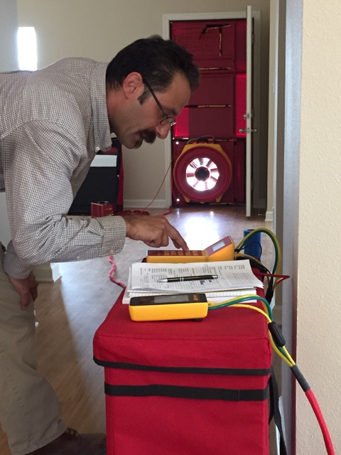

Seven years ago, Georgia led the nation. Yep. We were the first state to adopt an energy code that made blower door testing mandatory. All new homes built in the state had to show through performance testing that they had an air leakage rate of less than 7 air changes per hour at 50 Pascals of pressure difference (ach50).
When I wrote about it in 2010, I called our new code “groundbreaking.” Since then, we’ve been passed many times by other states. Now we’re finally updating the energy code here, and it’s been a struggle to move that threshold from 7 ach50 to something lower. And the reason has nothing to do with the difficulty of air sealing.

Since 2011, thousands of new homes in Georgia have passed a blower door test. One of the interesting things I observed early on was that home builders who had never had a blower door test done found it was pretty easy to hit 7 ach50. In fact, a lot of times they were coming in at 4 or 5 ach50.
The proposals to update to 3 ach50 in the northern part of the state (Climate Zones 3 and 4) and 5 ach50 in south Georgia (climate zone 2) shouldn’t be too hard, right? Builders can certainly get to 5 ach50 without a problem. Hitting 3 ach50 will be a bit of a stretch but is definitely doable.
Before long, however, it became clear in our meetings that we weren’t going to get below 5 ach50. Three ach50 was out, but it looked like we were on track for 5 ach50 until one of the big stakeholders pushed for no change at all in the threshold. That’s right. They wanted to stay at 7 ach50. But they might be willing to consider 6 ACH50, they said.
At the last subcommittee meeting, we seem to have made a little progress. The current proposal is to go to 6 ach50 for a year and then drop to 5 ach50. Yes, we have Climate Zone 2 in the south and 3 and 4 in the north, but we’re going to simplify to one threshold for the whole state.
I’m OK with this proposal — as long as we actually do get to 5 ach50 in a year. If that transitional year is used as a stalling tactic and we never get to 5 ach50, that’s not good. A house that tests at 7 ach50 is better than one at 10 or 15 ach50, which is probably where we were before 2011 when we didn’t test, but it’s still pretty leaky. At 5 ach50 max, we’d be doing pretty well, and not just because of airtightness.
