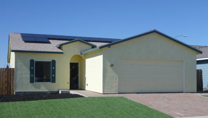

This 1,200-square-foot net-zero demonstration project for Habitat for Humanity in California cost less to build than the agency's standard, moderately energy-efficient homes. Decisions made during the design phase made all the difference.
Image Credit: San Joaquin County Habitat for Humanity
In an effort to find ways to make zero-energy homes more affordable, San Joaquin County Habitat for Humanity (SJC Habitat) went farther than most. Headquartered in Stockton, California, the non-profit organization found ways to make their zero-energy homes cost less to build than their standard, moderately energy-efficient homes.
A recent report on one SJC Habitat project documents almost $3,000 in construction cost reductions even as they brought the home to the zero-net-energy standard. Labor and material costs were reduced for heating and cooling, ductwork, water heating, and other measures.
How did they achieve these savings? The key was intelligent design and planning.

    Dana Dorsett | | #1
    Not necessarily- note, it's "Humanity standard" @ Malcolm
    The "standard" in question is their internal Habitat for Humanity standards, which are different from code-minimums or whatever the local tract home builders are doing. So you may be thinking of apples when it's really pears.
    Still...
    The reduced window area (compared to their standard) probably cost less, or broke-even after the upcharge for using slightly higher performance glazing, since the window area is replaced by higher performance/lower cost wall area.
    The increased cost of 24" o.c. 2x6 vs. 16" o.c. 2x4 construction is also dead-even or lower. It's fewer board-feet of material, (lower, since they could use single top plates), and fewer boards to cut. The R21 cavity fill is a real uptick over R11s (and probably not even necessary to hit Net Zero in that location), but the saving in framing costs at least partly offsets the cost of the insulation upgrade.
    Their basic argument isn't about picking the nits costs and energy-savings of each & every upgrade feature, but rather, that cost savings of the smaller mechanical systems the lower load more than any upcharge paid for building upgrades. The greatest cost adder may have been in the energy consultant fees, not the construction costs.
    The 3.36kw rooftop PV would be a serious cost uptick relative to most peoples "standard" construction, but is the same size as those used in the local standard (not net-zero) Habitat houses, and thus not a cost-adder. It's what all their houses get, no more, no less.
    The fact that it's do-able at a net cost savings from Habitat standard construction shows just how mild their climate really is. Starting in 2020 all new homes in California will be required to be Net Zero Energy, so this was a necessary learning & demonstration project for them. In most other climates getting to Net Zero has a real up front cost adder, but with a sharp design pencil it can be total construction cost negative in place as mild as San Joaquin County. (It's possible to hit PassiveHouse with 2x6 / cellulose walls there, but the windows are still going to cost a bit.)
