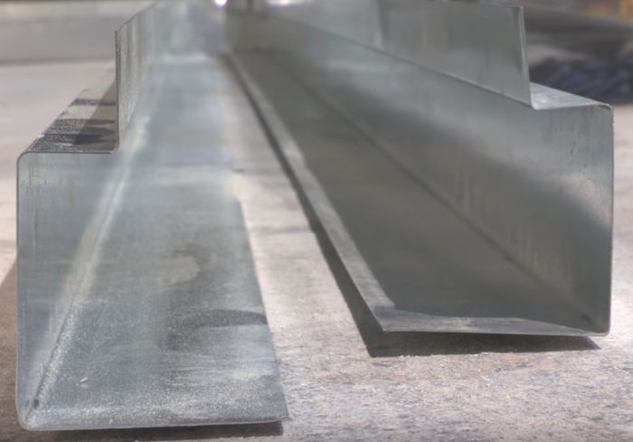

The galvanized steel profile is installed horizontally — usually on a concrete floor. This photo shows lengths of VersaDry screwed to the bottom of steel studs. VersaDry profiles have a 5/8-inch-wide ledge. The ledge is designed to support 5/8-inch drywall — the usual thickness of drywall installed on commercial jobs. Many institutional and commercial buildings worry about baseboard irregularities caused by impact from floor buffing machines.
I first “learned” about VersaDry when a colleague of mine here at BuildingGreen — our materials and product expert, Brent Ehrlich — sent me the photo reproduced at right. I was in the same boat you are right now: “OK, thanks for the photo, Brent, but what the hell is this VersaDry bent-metal thingamajig?”
He replied, “Oh, yeah, here is another photo that will help.” This time he sent me the photo reproduced as Image #2, below.
Brent was clearly messing with me, along the lines of when my wife says, “OK, Mr. Building Scientist,” for yet another building science mistake I have made or failed to explain well enough (or so overexplained that she lost interest long before I was done yapping).
Brent then gave another hint: “Displaying the VersaDry on a concrete floor is no accident.” Ah, OK, it is some sort of bottom-of-wall track system — maybe a wiring raceway?
Brent started to lose patience just a bit: “Come on, Pete: it is solving a moisture problem.” And just as the “aha” came for me, he sent the two photos reproduced as Images #3 and #4, below.
It’s installed at the bottom of a wall
VersaDry is a 26-gauge G40 galvanized steel track system designed to lift gypsum wall board (GWB) 2 inches off of the floor, protecting the drywall during construction and then if — or more likely, when — a spill or leak wets the concrete floor. The top “shelf” is 5/8-inch wide to receive Type X fire-rated GWB on each side of the wall. VersaDry also comes double-walled to accomplish a 1-hour and 2-hour fire-rated wall assembly (see Image #2, below).

Doug’s first approach was a single piece U-shaped bottom track, but it was a bear to stack and package efficiently. So one evening Doug was playing around with splitting the track in half — eliminating any bottom track — just to make it easier to stack and pack the track. As his wife was walking by she said, “Hey, Doug, splitting the tracks means you can use it on any width of wall, doesn’t it?”
It turns out that splitting VersaDry into two separate tracks also finally solved years of struggle to pass fire- and sound-rating tests. Doug holds the patent on this seemingly very simple, elegant solution that took years and years of refining.
