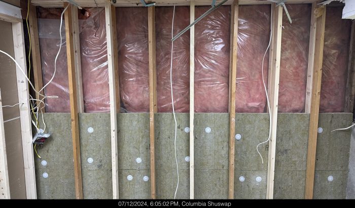

    I purchased a 60 year old home last summer and quickly upgraded the insulation on the basement interior with XPS foam and a 2x4 wall. I'm now planning to excavate the exterior of the home to address some drainage issues and run my downspouts into a common footing drain. I know this exterior work should have been done before interior insulation but we were short on time for energy rebates and it needed to be done during the winter.
    Outside, I hope to dig out around the foundation, installing a new footing drain and damp-proof the exterior concrete walls. I'm wondering while I have these trenches dug, is it still valuable to also wrap the exterior of the foundation in foam board too? Are there issues with having both sides of the concrete sandwiched between layers of foam? and will this exterior insulation still be cost effective?
    Thanks for the help!

    I an a HERS Rater in MA. We have many builders who insulate finished basements with fiberglass batts. Why do you categorically proscribe the use of poly anywhere in such an assembly? It seems to me that a single layer of poly directly against the concrete would keep exterior moisture away from the studs and fiberglass. Painted wallboard inside would serve as an air barrier that would minimize the amount of interior moisture coming in contact with the potentially cold poly, and it would permit it to dry to the inside. Is this not better than batts in contact with the concrete?
    What should I recommend to my clients who refuse to use anything but FG Batts in their above grade and below grade walls?

    Inspecting the unfinished areas of my basement (only Fiberglas and poly over wood studs) I find a thick frost covering the concrete. In this same area there is a major draft at the bottom of said wall cavity as the air has begun to actually circulate as warm air is pulled down by somewhat of a reverse convection over the freezing cold concrete. It's a dramatic effect at the bottom of the wall where the poly is not quite sealed allowing the draft to travel over the floor with reasonable force!
    The rest of the basement is finished with regular drywall over poly/wood studs and fiberglass against the concrete. I know there is something similar happening behind the drywall as I can smell a musty odor in the spring which would be when the ice condensate would start to melt.
    It's not so bad the carpet gets wet but you can smell the dampness in the room.
    To make matters worse my home is a raised bungalow. The concrete foundation walls extend roughly 5 feet above grade which makes for a large area of climate exposure to naked concrete. I can not insulate from the outside above grade as the design of the home wouldn't allow for it.
    I have been considering tearing down the inside walls, and addressing any mold issues that may be present. The home is 20 years old and doesn't have any obvious foundation cracks or seepage issues. For the re-construction I like the idea of interior rigid XPS straight over the concrete sealed to the nines allowing very little chance of air meeting the concrete. I'd like to have spray foam professionally done on the top portion in between the floor joist header area after the XPS panels are installed for the rest of the wall seems like it would help seal everything up well.
    What do you think of this combination of foam? Also, I would still like to use roxul inside the wall cavities that will make up the home theater area. This is strictly for acoustic treatment. I'm guessing no poly, just foam on the concrete then the roxul, then the mold resistant drywall ontop of wood 2x4's. What are your views on this?
    Here my province the building code still specifies 6 mil poly over fiberglass / wood studs in basements below grade. Most of the new homes I have had a chance to see will have about 2" of ice and frost on the concrete underneath the poly, fiberglass. Obviously this is NOT the right thing to be doing.

    Your experience is a good confirmation of the reasoning that has led me, for years, to advise builders to avoid the use of fiberglass batts and polyethylene on below-grade walls. Your plan to correct the errors in your house makes sense.
    Q. "What do you think of this combination of foam?"
    A. Your plan to use XPS on the walls and spray foam on the rim joist area should work fine. Be sure that you meet your local code requirements for covering the foam with an ignition barrier or thermal barrier. If the foam is covered with gypsum drywall, you should be fine.
    Q. "Also, I would still like to use Roxul inside the wall cavities that will make up the home theater area. This is strictly for acoustic treatment. I'm guessing no poly, just foam on the concrete then the Roxul, then the mold resistant drywall ontop of wood 2x4's. What are your views on this?"
    A. That should work.
    Q. "Here my province the building code still specifies 6 mil poly over fiberglass / wood studs in basements below grade. Most of the new homes I have had a chance to see will have about 2 inches of ice and frost on the concrete underneath the poly, fiberglass. Obviously this is NOT the right thing to be doing."
    A. I agree. Considering your climate, this example of code stupidity is particularly glaring.

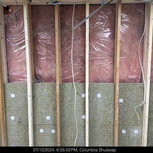

  89. aaron_calgary | | #89
    Question about finishing a basement in a new home
    I am currently looking at finsihing up my basement in my 3 year old home. After much research along with this article I am convinced that these are the best practices to follow. However that being said, my basement is very dry and no issues (that are noticeable). I live in a very harsh climate where it can get to -30c in the winters.
    The basement was left with R12 fibreglass from floor to rim joists stuffed in between framing along all the walls , pressed directly on the concrete wall. A loose sheet of poly is stapled along all the framing.
    So my question is what do you recommend going forward to effectively finish these walls?
    1) Remove all poly, fibre and framing and start from scratch following the practices as indicated in the article
    2) Remove the fibre and poly and fill in the 2 foot sections in between the framing with rigid insulation and foam all the edging within the framing. However this would mean the framing is still up against the concrete directly too.
    In either option can I reuse all the R12 and put on top of the rigid insulation again (with no poly) and cover with drywall without issues or just toss the fibreglass?
    Any feedback is greatly appreciated
  90. GBA Editor
    Martin Holladay | | #90
    Response to Aaron De Boer
    Aaron,
    The safest approach is to remove the polyethylene and fiberglass, and remove (or loosen) the stud wall components so that the stud can be moved inward, creating a gap between the studs and the basement wall. That would make it possible to install closed-cell spray foam.
    However, all that work is daunting (and potentially wasteful). If you don't find any dampness or mold behind the fiberglass, you could adopt another approach: watchful waiting. If your basement is so dry that you don't have problems, you could leave well enough alone. It's your choice.

    Roxul section comments
    Martin - Can you comment on any pitfalls of the recommended basement wall section outlined in the Roxul Comfortboard IS Basement Application Sell Sheet? The section shows a concrete foundation wall, then an "Air/Moisture Barrier", then the Roxul Comfortboard, then stud wall with Roxul batts, then a vapor barrier, then the drywall...
    http://www.roxul.com/files/RX-NA_EN/pdf/Sell%20Sheets/ComfortBoard%20IS%20Basement.pdf
    I've been researching this topic for several months and had landed on this basement wall section, until I read this article.. But then I think twice that the Roxul team would recommend a section that has been a proven to failure... Do you feel this section is different enough from older diaper wall/poly sections that it could survive? I'm in St. Louis, MO, Zone 4A / Mixed-humid. Currently I have rolls of CertainTeed Membrain to use both against the concrete and behind the drywall, and lots of Roxul on order. I'm more concerned first about the mold issue, second about R value.
    Additionally, the back wall of the basement is a studded wall (Walkout basement). Based on your article, would you also not recommend poly (CertainTeed Membrain in my case) on this wall section? The walkout wall is vinyl siding, Tyvek wrap (lapped and Tyvek-taped properly by me one night after the builder got it wrong), 1/2" insulated sheathing, 2x6 studs.. See attachment.
    Attached are the wall sections I have planned currently, but after reading, I'm wondering if I should scrap a lot of that and go with the rigid foam?
    I certainly appreciate any commentary. I really try to avoid this type of pointed question, but in months of searching I've found so many conflicting articles and so many just seem to simply be outdated... I was surprised to read the Lstiburek post you link to where he admits some of his older advice is obsolete... Which is why I hope my question can clear up a lot of questions for not only myself, but for other readers as well.
  94. GBA Editor
    Martin Holladay | | #94
    Response to Randy Cook
    Randy,
    I hate to be blunt, but Roxul is in the business of promoting the use of their products. In that respect, they don't differ from any other insulation manufacturer. They want to sell more mineral wool.
    If you have a dry basement with no water entry issues and perfect interior drainage, and if the interior relative humidity of your basement stays low all year round -- including during the summer -- it's perfectly possible to use fiberglass batts or mineral wool to insulate the interior of your basement walls. Plenty of people have done it, and if your basement has the conditions I described, fiberglass or mineral wool can work well.
    The problem is that many basements aren't as dry as the one I described. Once we're dealing with a basement that is occasionally humid, we're stepping into a new territory, and the use of interior air-permeable insulation becomes risky.
    The Roxul brochure you linked to isn't based on building science. The brochure specifies the use of an "air/moisture barrier" (material not specified) between the Roxul and the concrete wall; but there is no need for an air barrier at this location, because concrete is an air barrier. If polyethylene is used, it's very possible that moisture will condense on the interior side of the poly when the interior air is humid. This moisture will dribble down the poly and puddle near the bottom plate.
    Determining which material to use depends on many factors: not only on cost, but on how much risk you want to assume. If you're like me, and don't like risk -- and you don't want to tear out your basement walls in 6 years to fix them -- I suggest that you use rigid foam or spray foam to insulate the interior side of your basement walls.

  183. freedomverse | | #183
    half basement with concrete sill
    What is the best way to insulate my basement wall? (picture attached)
  184. GBA Editor
    Martin Holladay | | #184
    Response to Jared Weber
    Jared,
    Well, if he's still there, the easiest way would be to tell the spray foam guy in the photo to aim his wand at the walls.
  185. GBA Editor
    Martin Holladay | | #185
    Second response to Jared Weber
    Jared,
    I'm not sure there is a "best" way.
    The above-grade portion (the portion with stud walls) is insulated the same way as any above-grade wall.
    The concrete portion of the wall is insulated as described in the article on this page.
    If you want the interior wall to be co-planar, you can install floor-to-ceiling studs on the interior side of the insulation once the insulation work is complete, and then install drywall or plaster.
  186. freedomverse | | #186
    half basement insulation
    That handsome guy in the super-suit was painting the ceiling joists (which will be left exposed)... same guy will be doing the insulation...
    Thanks for your input. I guess I have a couple additional questions.
    First, is the standard pink fluffy stuff I see in Home Depot the way to go for the above grade portion? I also see there are alternatives at the store such as Rock Wool and various types of foam panels
    Second, for the space between the ceiling joists, which is hard to see in the picture... I saw a video where XPS foam and "great stuff" was used to insulate the rim joist area -- my rim joist area isn't exactly the same as the video because it doesn't' but up right against the foundation wall -- what would you suggest for this area?
    Lastly, and maybe this is overkill... but if I used traditional insulation between the studs would it be a good or bad idea to put 1/2" XPS over the studs before I install my drywall to get a little bit more R-value down there?
  187. GBA Editor
    Martin Holladay | | #187
    Third response to Jared Weber
    Jared,
    Now that I think about it, I should have realized that the guy in the suit is a painter, not a spray foam contractor, since his wand has only one hose, not two hoses.
    Q. "First, is the standard pink fluffy stuff I see in Home Depot the way to go for the above grade portion?"
    A. It sounds like this type of work is new to you. If possible, try to find an experienced contractor to guide you. Either fiberglass batts, mineral wool, cellulose, or spray foam can work, but whatever insulation material you use, it has to be installed properly. In case you end up using fiberglass batts, I'll provide a link to a relevant article: "Installing Fiberglass Right."
    Q. "I saw a video where XPS foam and Great Stuff was used to insulate the rim joist area."
    A. Here is a link to an article to advise you on that work: "Insulating rim joists."
    Q. "If I used traditional insulation between the studs would it be a good or bad idea to put 1/2 inch XPS over the studs before I install my drywall to get a little bit more R-value down there?"
    A. Installing interior rigid foam is fine, but most green builders avoid the use of XPS, which is manufactured with a blowing agent that has a high global warming potential. Either EPS or polyiso would be a better choice. Here are links to two articles you should read:
    "Walls With Interior Rigid Foam"
    "Choosing Rigid Foam"
  188. cactus12 | | #188

    As you from the attached photo, the basement wall in my 1972 built house was constructed with 2x4 framing [A] on a 4 foot high concrete foundation wall, the depth of the concrete being 8 inches.
    I installed a 4 foot 2x4 pony wall [B] atop this concrete foundation wall which leaves a 1 inch space between [A] and [B].
    And then an 8 foot floor to ceiling 2x4 wall [C] in front, 1-1/2 inches away from the concrete.
    In that 1-1/2 inch space, not realizing that Rockwool Comfortboard 80 is air permeable, I attached it to the concrete foundation wall.
    So to correct this error, I would replace the Comfortboard 80 with 2-inch x 48-inch x 96-inch R-value 8.54 EPS rigid insulation foamboard like Durospan 250, installing it floor to ceiling.
    This of course would require 2x4 wall [C] to be 2 inches from the concrete foundation.
    I would also remove the existing fiberglass batts existing inside the cavities of [A] and then “cut and cobble” 1 inch EPS foamboard between the now empty stud cavities, gluing same against the underside of the exterior sheathing.
    I would then do the same with the removed Comfortboard 80, adhering it to the 1 inch EPS.
    That would then leave 5-1/2 inches which I would fill with 2x6 size Rockwool Comfortbatts.
    The batts would thus meet up with the backside of the Durospan 250.
    As to 2x4 wall [C], i would leave the cavities empty and no poly before then covering with drywall.
    What about my insulation plan?
    Without considering local code compliances, would it be successful?
  260. Malcolm_Taylor | | #315
    Zopkios,
    Since the only potential problem with your current set up is that the rockwool against your concrete stem-walls is air-permeable, why not just replace it with a similar depth of foam board and be done?
    1. Zopkios | | #316
      Cost is my only reason. Not just for foam in lieu of Rockwool batts but utilizing the Comfortboard 80 I will be removing. Even so, I may end up doing exactly what you suggest.
      1. Malcolm_Taylor | | #317
        Zopkios,
        I suggested it mainly because there doesn't seem to be much reason to touch what you have so capably done on the upper framed portion of the walls, the framing, or to add full height foam board. I'd put the Comfortboard in the stud bays, making up whatever depth you need with batts.
