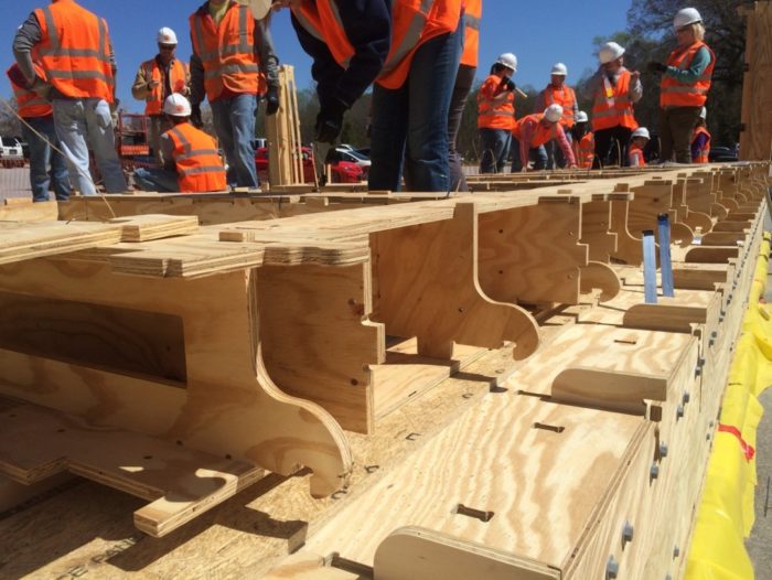

Students and faculty at Clemson University’s School of Architecture are developing a framing technique that will allow buildings to be assembled rapidly from pre-cut plywood components with a minimum of tooling and using mostly unskilled labor.
According to a post at Clemson’s website , the “sim[PLY]” building system grew out of the university’s 2015 Solar Decathlon entry. Plywood components are cut to shape with a CNC router and can be shipped to the building site flat. Developers say assembly, which relies on slot-and-tab plywood connections and stainless steel zip ties, is intuitive.
“With a click of the button, someone could order a custom-cut, flat-packed home online and construct it by hand with the help of their friends and neighbors in a matter of days,” said Kate Schwennsen, professor and director of the School of Architecture.
One advantage of the sim[PLY] approach, the university says, is that digital construction plans could be emailed to any shop equipped with CNC tooling, and building pieces cut out of standard sheets of plywood. The components can be assembled without the need for power tools or heavy equipment. Buildings can be taken apart as easily as they are put together without damaging the components.

Daniel Harding, an architecture professor at Clemson who led the design and building team for the Solar Decathlon house, said a sim[PLY] building resembles a conventionally framed building with bottom plates, studs, and roof trusses and other familiar components. The difference is that parts are milled from 3/4-inch, off-the-shelf plywood, and held together not with nails but slot-and-tab connections and stainless steel zip ties.
Plywood framing is on a conventional 4-foot grid, but stud spacing can vary from just under 2 feet to about 1 foot, depending on the loads the walls will be subjected to, Harding said. Studs look like Larsen trusses, a design that simplifies plumbing and wiring runs while reducing thermal bridging.
Finding an alternative to the nailed connections in conventional framing was key, Harding said in a telephone interview. Without nails, said the former general contractor, there are no nail guns, no compressors, and no need for air hoses and extension cords. Instead, zip ties hold plywood components together until structural loads are absorbed by the completed assembly. That reduces waste, improves job site safety, and makes it just as easy to take the building apart as it was to put it together.
“The idea was that if we can reconfigure the way the wood is put together, to use a different metal connector, we can use the metal to hold the building together rather than a compressive spike in shear. We redesigned our whole system around how we would use metal and fasteners differently,” Harding said. “It follows the logic very similar to that of traditional light wood framing in that there are studs, there are sill plates connections, and hold downs — very similar to platform framing. It’s just the work is being done with the way these plywood parts are designed and held together with stainless steel zip ties.”

The system isn’t ready for use on a wide scale just yet. Clemson builders have so far put together just four buildings, including the Solar Decathlon entry that will be repurposed later this year as an affordable housing unit in South Carolina. And the group is still working on some sticky technical issues.
Clemson architecture student Paul Mosher with sim[PLY] pieces cut by a CNC router.
Among them is the maximum length of building components, currently limited to 8 feet because parts are cut from standard sheets of 3/4-inch plywood. Until the team designs and tests splices to connect components, buildings will be limited to one story in height. Harding says the group will be working on plans for a multi-story building and already has developed some simple prototypes and models for the connections that will allow the system to grow beyond its current limits.
Code acceptance is another potential issue, although Harding says building officials Clemson has worked with so far have been receptive and approved the designs for occupancy. In the 2015 competition, for example, Clemson had to meet California’s code requirements for a public assembly structure, and buildings now in use in South Carolina had to pass muster with building officials before they could be used. In all, Harding said, the framing system is equal to or better than conventional light wood framing.
