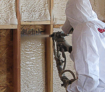

An owner-builder planning a new home in southern Ontario isn’t looking for a net-zero house, just one that’s well insulated and protected from moisture problems. The question is whether his proposed wall system is his best option.
“I’m unwilling to put foam board on the outside and vapor barrier on the inside,” writes User 6782048, whom we’ll just call Ontario, in a question posted on our Q&A page. “Just seems wrong.”
He does plan on some exterior foam — a 1-inch-thick layer over the studs, followed by plywood and then Tyvek housewrap. After rough wiring, the 2×6 wall cavities would get a 2-inch layer of closed-cell foam and then batt insulation.
The technique of combining spray foam with batt insulation is called “flash and batt”, and Ontario believes the total of 3 inches of foam would keep the exterior sheathing above the dew point in winter, thus reducing the chance of moisture condensation inside the walls.
“Thoughts, please!” Ontario writes. That’s the topic for this Q&A Spotlight.

Filling a stud cavity with closed-cell foam provides an excellent air seal, but it’s expensive — and that’s why some builders advocate the flash-and-batt approach. But, writes Andy Chappell-Dick, it’s still costly, “it relies on the least ‘green’ insulation, and it’s interrupted (and thus substantially degraded) every 16 inches by a stud.”
The technique may be useful in tightening up an old house in an efficiency-inspired renovation, but for new construction it would be better to put all of the foam on the exterior of the house. Further, Chappell-Dick adds, it would be wise…

I'm having a home built in Ontario. I want to improve the thermal performance, and one of the easy ways to do this is to simply fill the existing 2*6 wall cavity with spray foam.
I think that would give me an R-35 wall assembly. 5" of closed cell, + 1" EPS rigid insulation in the outside. I'm worried about this assembly drying though. The inspector will almost certainly demand a polyethylene vapor barrier.
Would an assembly like this sufficiently dry to the outside? I guess through the osb and EPS? seems like if any water at all gets in your done. Thoughts?

I really don't recommend the wall assembly you describe. (And putting polyethylene on the interior is especially nuts. Don't building inspectors in Canada know that 5 inches of closed-cell spray foam is a vapor barrier?)
The wall you describe would probably work (from a building science perspective), as long as the wall had good flashing. Needless to say, a rainscreen gap between the siding and the WRB would help.
The problems with this wall have to do with its high cost (that's a lot of closed-cell spray foam), its environmental impact (bad, because of the blowing agents in the foam, unless you choose one of the new closed-cell spray foam with a more benign blowing agent), and the fact that the 1 inch of EPS is insufficient to do much to address thermal bridging through the studs.
In Southern Ontario (Climate Zone 6), the best approach for a 2x6 wall would be to include thicker rigid foam (a minimum of R-11.25 of rigid foam, which means about 3 inches of EPS) and to install fluffy insulation (fiberglass, mineral wool, or cellulose) between the studs. This type of wall doesn't need an interior vapor retarder, but if you have an old-fashioned building inspector who is hard to educate, you can install interior MemBrain, a "smart" retarder, instead of polyethylene.
