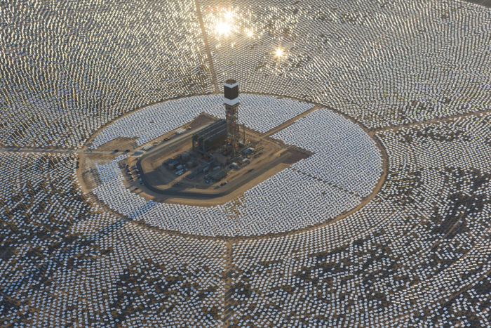

The Ivanpah solar plant in California uses natural gas to generate power when sunlight alone isn't enough
Mirrors arranged around a central tower use sunlight to create steam that drives a generator. But sometimes the sun isn't enough.

Power tower
Unlike the photovoltaic (PV) panels that are proliferating on rooftops such as my own, Ivanpah generates its power by angling mirrors to gather the intense sunlight of the Mojave Desert to produce heat. The mirrors reflect sunlight onto three power towers, where steam turns turbines to generate electricity.
This “concentrating” solar thermal approach is even more sensitive to clouds and particles than PV panels, since the mirrors can concentrate only the sunlight that arrives in a direct beam from the sun. Clouds and particulate matter scatter the light into directions that can still be utilized by photovoltaic panels but not the precisely angled mirrors.
Ivanpah was designed and built to burn some natural gas to maintain peak power generation during times of intermittent clouds. Without the natural gas, Ivanpah’s steam turbines could trip off-line, interrupting power generation. The extra energy from natural gas can enable peak power production to continue until sunny conditions resume or the turbines pause for the night.
