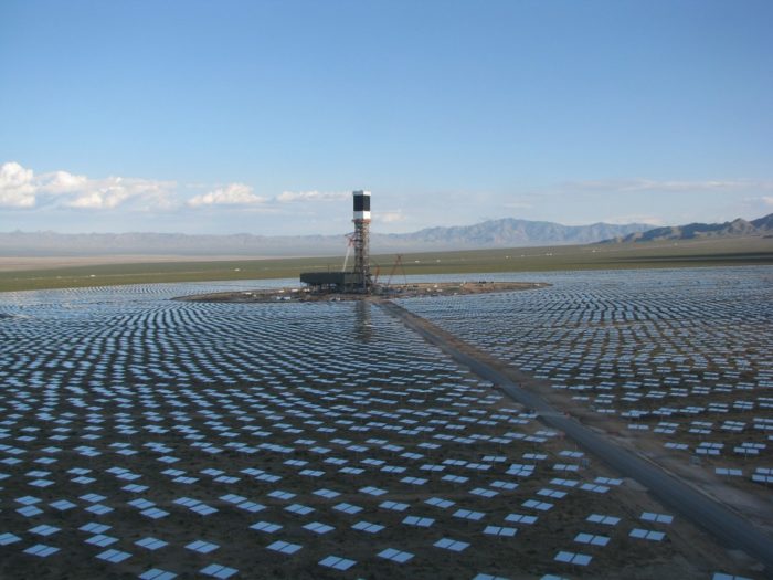

![](http://images.greenbuildingadvisor.com/app/uploads/2018/07/24200813/Ivanpah%201-main-700x525.jpg)
