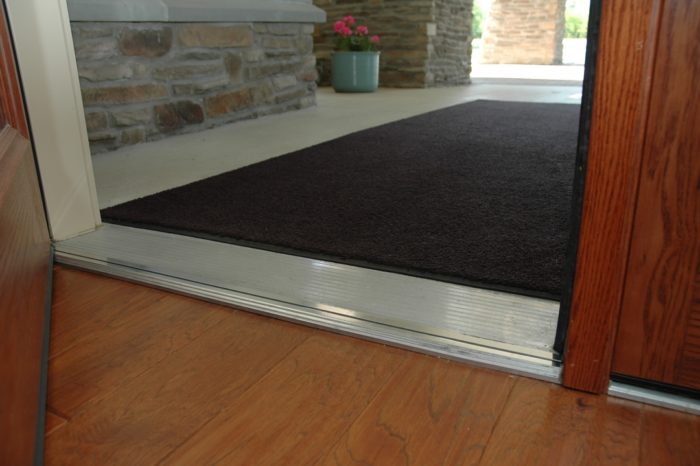

This threshold says “Welcome” to all visitors. When specifying a low threshold on an exterior door, it's important to provide a minimum of 4 feet of exterior roof overhang. To limit water entry problems, it's also a good idea to install sill pan flashing (for example, using peel-and-stick flashing) under the threshold.

Wide doors with lever handles
To make each room more accessible for people who use wheelchairs or scooters, install 36-inch-wide doors. Also, install lever handles rather that door knobs (see Image #8, below). Lever handles are easier to operate for people with paralysis or arthritis. The cost difference for these wider doors and lever handles is minimal. The benefits are long-lasting, providing for independence and greater access to the entire home.
Exterior door thresholds should be ½ inch or lower to be easier to roll over in a wheelchair. The exterior main door should have multiple height peepholes or include glass in the design so that all residents can view the porch to see who is there.
