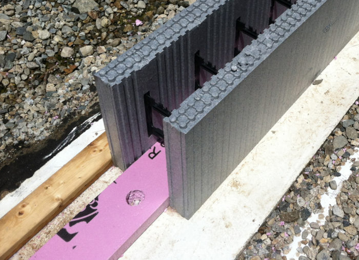

Image Credit: Kaplan Thompson I mentioned in the podcast that I had a photo of this product. This is a THREE sided tape. It's hard to tell in the photo, but the third tab of the tape is already stuck to the top of the concrete with the peel and stick sill seal/capillary break over it. htese other two tabs are ready to be adhered to the white poly below (that goes under the slab, and to the WRB.

Chris: We’ll get into ICFs in a little bit – like the Passivhaus that I did in Saco – Roger Normand’s Passivhaus (Edgewaterhaus: I’ll give it a little plug!). I came up with this detail (and I was surprised that I seemed to be original about it).
Phil: I’m not surprised. You’re smarter than you look.
Chris: Well, thank you (Wait!). Where the ICF meets the footing – you pour a footing, business as usual – you put high-density foam right there along the bottom (it’s almost wedged in at the bottom of the ICF), and you pour the ICF wall on that. So, basically, the wall is this thermal mass inside this insulated thing.
Phil: Essentially, it’s sort of a chunk of EPS that sits right in the bottom of the ICFs – just in that middle piece of cavity.
Chris: Exactly. And I ask my engineer, “Why can’t I do this?” and he says, “Well…”
Phil: “Well, I’m an engineer, so I’m going to say ‘No’ before I…”
Chris: No, no. My engineer’s great. Joe Leasure. He’s a great guy; great guy. Give him a little shout-out: L&L Engineering. He’ll handle the creative stuff.
He said, “Well, structures bear on the most rigid thing. So, what will happen is: it will compress (especially as it’s curing) but then, all of your little rebar that’s sticking out – that’s tying the footing to the wall – is going to take all the load.”
Phil: So…?
Chris: Exactly. And I said, “So…?” and he said, “So, you’re probably fine because there’s no way you’re going to crush that one-inch piece of steel, especially if it’s every three feet. But – here’s the thing – that steel is now open to moisture so it could (there’s not a lot of oxygen in there…) hypothetically spall. So I’m going to call for epoxy-coated rebar.” And I said, “are we done; we got it?” and he said, “yeah” and I said, “alright. We’re doing it!”
Phil: That’s cool! Post that, Chris. That’s good.

Chris: Eyes wide open, people. Here’s the thing: if you’re insulating your foundation – the thing is, you can screw sheet rock right to it – have your builder run the numbers in terms of whether it’s cost-effective. And for you, and for that builder, it might get written off and deleted and then you go with something else. And I’m fine with that.
Phil: Bottom line is that it’s not a bad product.
Chris: Not a bad product.
Phil: It’s a good idea. And maybe it’ll come down in price.
Chris: But it’s not the only way to do this.

ICF's are da bomb
The house I'm building now is the second I've done with ICF's. This house had more bumps and corners than the rather simple boxy duplex we poured last fall but no issues complete breeze. With ICF's I have been able to get rid of the concrete subcontractor, we pour our own footings and do our own flat work. There are no time delays waiting for a sub and we can control the quality...make it perfect.
As to the r value debate of ICF's , you can always add more to the assembly.
As to costs, I have found them to be competitive or less than the cheapest concrete contractor in town.
To me it's all about being able to do another portion of home construction myself and it's kind of fun working with the giant Lego blocks.
