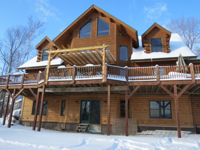

Early settlers who felled their own trees to build log homes were probably so grateful to be out of the weather they didn’t worry about air leaks or cold walls. But when your heating bills are $500 a month, it’s a different story altogether.
That’s the situation facing ADK Homeowner, as he explains in a Q&A post at Green Building Advisor.
“Built the dream log home and now face the heating nightmare in Climate Zone 7,” ADK writes. “A masonry heater reduces the heating load of my in-floor heating system by half but without it my heating bills [average] $500 a month.”
ADK has a plan. On the inside of his log walls, he wants to install between 1/2 inch and 1 inch of rigid foam insulation, followed by log siding installed on the interior (to preserve the aesthetic he liked so much to start with).
“I am thinking the rigid foam provides a thermal break and the log siding maintains the log look,” he writes. “The insulation and log siding will not be cheap, but my heating season goes from late October through March or early April, and at least three of those months have many sub-zero days. I can afford to lose the 2 inches to 2 1/2 inches of space per room and the labor would be mine.”
Will it work? Or is this plan just plain crazy? That’s the subject of this Q&A Spotlight.
You need more foam
“The easiest thing to do is to sell your home and buy a home with tight walls,” counsels GBA senior editor Martin Holladay. “It’s very hard to fix log homes.”
Holladay’s suggestion may be tongue-in-cheek, but he’s certain that ADK’s proposed foam layer isn’t nearly thick enough. He should really be looking for a way to add…

Air leakage seems suspect, plan seems workable...
IF the logs were well sealed they should give an R-value of about R8, about typical for an R13 stud wall. Assuming an interior temp of 70degF, however, the wall temperature in the low 50s indicates an effective R-value of more like R3.5 indicating lots of infiltration: not efficient, not comfortable.....but the air won't feel stale!
On the other hand, even adding 1" of polyiso would add R6 and reduce the air leakage, thus increasing the logs to more like R8 and the whole wall to R14, a 300% improvement. Ignoring the infiltration benefits still improves R from 3.5 to 9, a 150% improvement.

To really air seal a log structure requires building a true air barrier on one or both sides of the walls.

First, you should know that there are no advantages whatsoever to log construction compared to frame construction, unless you live in a very remote location where the only access is via a footpath.
As you correctly note, the only reasonable way to insulate log walls is to install interior framing, at which point the question arises: "Why not build a frame house? I have to buy the 2x4s or 2x6s in either case, and logs make lousy siding." (Old log houses often have exterior moisture problems, due to wind-driven rain, unless your building has very wide roof overhangs.)
The key to a high-performance wall is air sealing. Insulation details are secondary. Make sure your walls are airtight -- not easy with log walls, but possible if you install interior framing.
If you can make your walls airtight, the moisture problems in your logs will all be due to exterior moisture (rain), not interior moisture traveling through the walls by diffusion.
