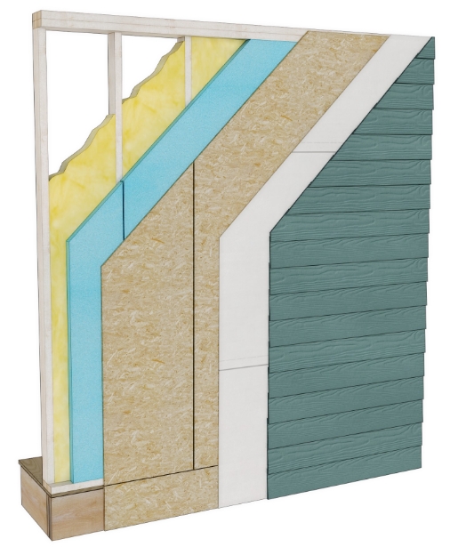

Production builders in the U.S. love 2×4 walls. They also love keeping the cost to build their homes as low as possible.
When energy codes ratcheted up in the 1980s and 1990s, cold-climate home builders eventually switched to 2×6 studs. But most production builders are still reluctant to install exterior rigid foam or furring strips.
In Climate Zones 6, 7, and 8, new codes are forcing builders to consider the implications of the “R-20 + R-5” requirements for walls. But many builders are unhappy with current options for building high-R walls.
Responding to builders’ concerns, engineers at a research facility associated with the National Association of Home Builders (the Home Innovation Research Labs, formerly known as the NAHB Research Center) have developed a new wall system called the “extended plate and beam” system. The main developers of the system were Vladimir Kochkin and Joe Wiehagen. (Wiehagen recently left his job at the Home Innovation Research Labs). Kochkin and Wieghagen wanted to come up with a wall that performs better than a typical 2×6 wall, but that isn’t expensive or scary enough to disturb production builders.
Cantilevered plates
At its most basic, here’s the idea: builders should frame 2×4 walls on 2×6 plates. The 2×6 plates should be flush with the 2x4s on the interior, but should be proud of the studs on the exterior. The protruding plates leave room for 2 inches of rigid foam to be installed on the exterior side of the studs (see the close-up image below).
The OSB or plywood wall sheathing is installed on the exterior side of the rigid foam. In this respect, an “extended plate and beam” wall resembles a wall with Zip R sheathing. (For more information on Zip R sheathing, see “Nailbase Panels for Walls.”)

I'm in zone 7, Northern Minnesota, where building inspectors are requiring a vapor barrier. I'm assuming the best option would be a "smart" vapor barrier. Would the 2 x 4 wall then get R-13 fiberglass bat giving the wall a total of R-23? I'm an energy auditor trying to convince builders to change the way they are approaching insulating and air sealing. This wall assembly may be a good start for some of them.
Response to Randy Williams
Randy,
Answers to both of your questions can be found in one of the documents I linked to (“A Builder’s Guide: Extended Plate & Beam Wall System”).
R-value calculations for the wall system can be found on page 3 of the Builder's Guide. The combination of R-10 rigid foam plus R-13 batts yields a calculated whole-wall R-value, according to the guide, of R-21.7. This value is less than R-23 because of thermal bridging through studs and plates.
Vapor retarder recommendations are found on page 13 of the Builder's Guide. The guide notes, "According to IRC Section R702.7 and Table R702.7.1, Climate Zones 1-4 do not require vapor retarders. Climate Zones 5-8 and Marine 4 require a Class I or II vapor retarder on above-grade walls unless certain conditions regarding vented cladding or continuous insulation are met. Because an EP&B wall includes a 2-in. layer of continuous insulation, in most cases a Class III vapor retarder may be used. ... If the configuration you’ve chosen does not qualify for Class III interior vapor retarder, then Home Innovation recommends a Class II vapor retarder, such as Kraft facing on batt insulation. Proprietary “Smart” vapor retarder products have perm ratings that rise with increasing relative humidity from 1 perm or less at normal conditions (Class II) up to 35+ perms (vapor permeable) in high humidity, and represent a “belt and suspenders” approach. Home Innovation discourages the use of polyethylene sheeting as an interior vapor retarder as it may create a double-vapor barrier condition, trapping incidental moisture and limiting drying."
