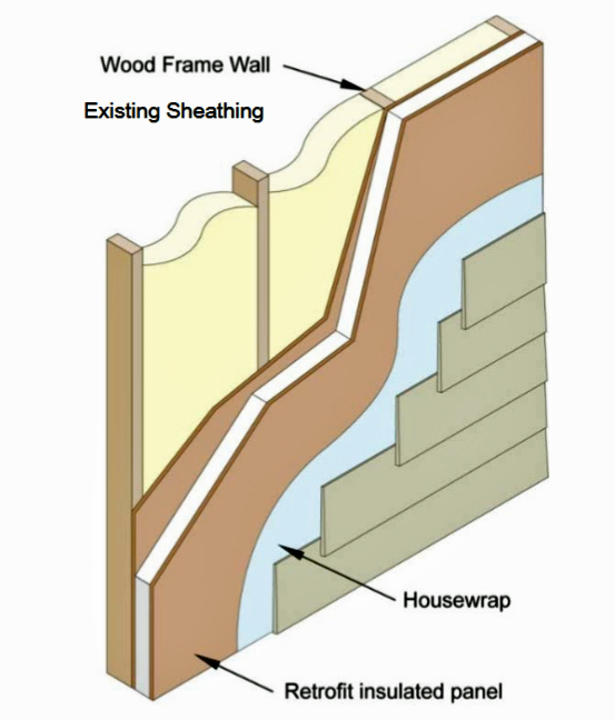

These days, lots of builders are installing a continuous layer of rigid foam on the exterior side of their wall sheathing. The usual approach is to sheathe the wall with OSB or plywood, and then to install one or more layers of rigid foam outboard of the sheathing.
Some builders are beginning to simplify this process by switching to nailbase panels — rigid foam panels with a layer of OSB or plywood glued to one side. Since nailbase panels provide sheathing and foam insulation in a single panel, they should (in theory) simplify the construction process.
Although nailbase panels were originally developed for use on roofs, an increasing number of nailbase manufacturers are beginning to realize that they can also market their products for use on walls.

This article will attempt to address several technical questions surrounding the use of nailbase panels on walls, including these:
- Should the rigid foam face the exterior or the interior?
- Can nailbase panels be used to brace a wall?
- What’s the minimum R-value for a nailbase panel in Climate Zone 4? Zone 5? Zone 6? Zone 7?
- Does this type of panel limit siding choices?
