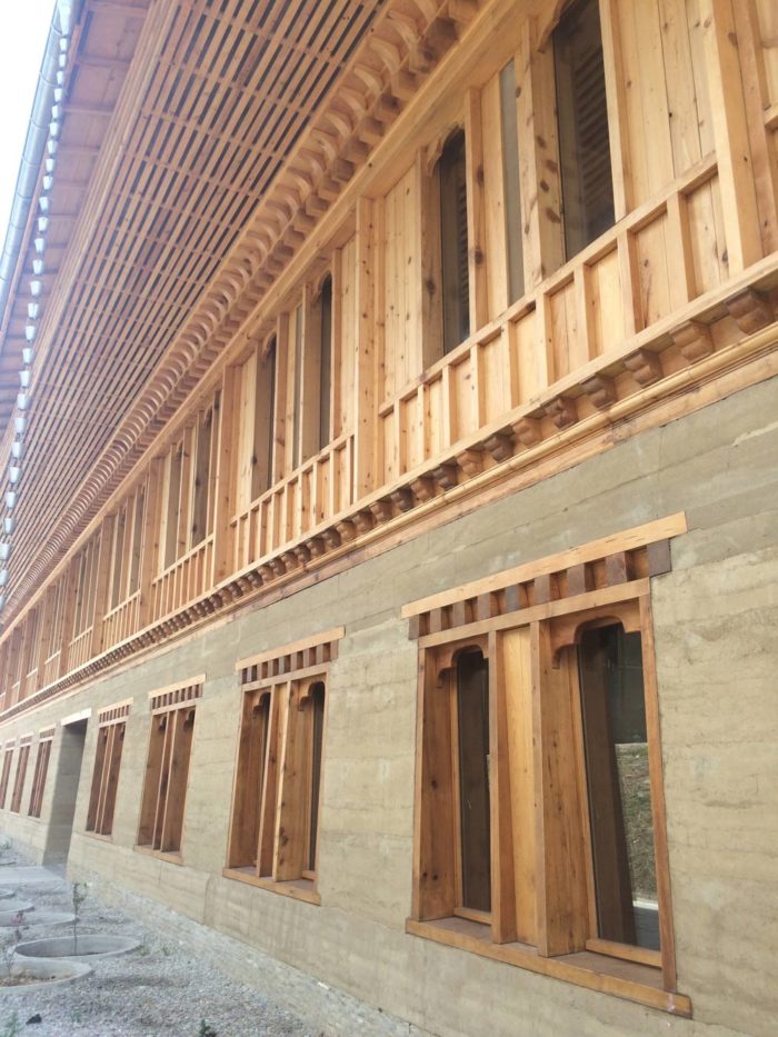

Take a look at this new rammed earth structure I saw in Bhutan (photo at right). Note that at the base of this rammed earth structure is stacked stone. I don’t know the exact history of this, but the layer of stone functions to break the rammed earth portion of the structure from the potentially damp soil, therefore short-circuiting any capillary action that would move water from the ground up into the structure.
This was a common detail used for every ancient rammed earth structure I saw in Bhutan. And it’s similar to rammed earth construction I have built that sits on concrete foundations. The top of the concrete foundation is coated with a capillary break to act as a similar short-circuit for water from the ground.

The building in the first photo looks incredible. Is there any way to find out more about it or see more images? And are buildings like that at all typical for new construction in Bhutan?
