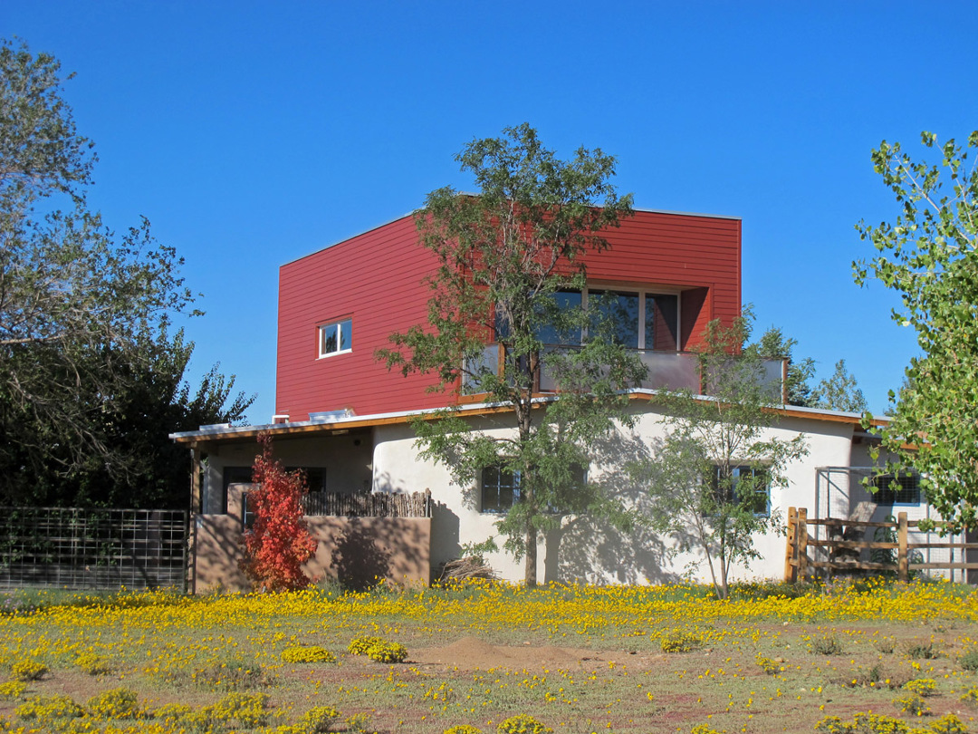

![](http://images.greenbuildingadvisor.com/app/uploads/2018/07/24232210/01%20East%20View-main.jpg)
Image Credit: Michael Grant
Image Credit: Michael Grant West view approaching the front door

This addition has a tight envelope, thick insulation, a heat-recovery ventilator, and a roof that harvests rainwater

As a continuing student of design, I was learning a new 3D CAD program, and thus of course I modeled our 1,150-square-foot rectangular adobe into the computer and began to play with design options.
Standing on the roof made the mountain views irresistible, convincing us that we would have to build upwards. A friend of mine, also an architect, suggested the radical idea of juxtaposing a modern addition against the traditional home, and that philosophically this would be the only honest renovation we could make. Since Santa Fe was already teeming with “faux adobes” (meaning framed walls trying to look like true adobe walls), I ran with the idea.
Selling such unconventional ideas to our neighborhood would prove a bit more of a challenge, but going door-to-door to discuss our intentions in person offered a wonderful opportunity to connect with folks and win votes. And our neighbors surprised us. I was floored when most of them grew genuinely excited about Julia’s idea to use the color red for our exterior cladding. And so red was exactly what we used.
The result was a true marriage between old and new, and the various eccentricities that emerge from a home that has sheltered generations of people, our animals, and our collective quirks over the years. Julia and I both feel that living in a modern-traditional hybrid brings us the best of both worlds.
